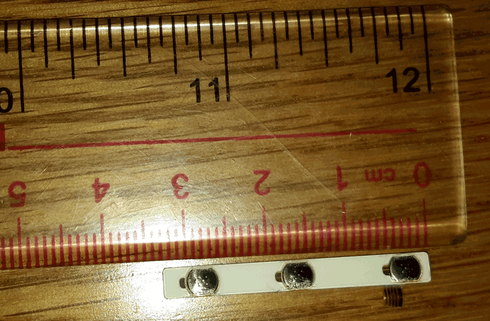

hello, i need to identify a tablet (fusion5 tablet) power and volume switch but am no expert. i think its called a membrane switch but still I'm having problems on how and where i can find a replacement part.
hopefully its a general component
any help would be greatly appreciated and will gladly send you a payment on paypal for any help
with this post one can find a photo of it
thanks

Does the switch work but the attached ribbon is broken?
thanks for the fast reply :) yes the ribbon is broken(therefore it does not work) and that's why i need a replacement. thanks

What you have is snap-disc switches on a rigid-flex circuit. Each switch is a stamped dome made of very thin spring steel and plated, then soldered onto the board over a contact pattern. The board/flex cable is 100% custom designed and fabricated.
If you are sure the flex has failed you can scrape away the plastic film around the break and attempt a repair, but the odds of success are extremely low. The copper trace is very thin; that's why it can flex.

the part where the ribbon is inserted (on the tablet) contains 4 contacts going to the board. if i short the contacts then the power and volume works.
how possible it is to fabricate such a ribbon? i mean, is it something that a diy can do or one needs equipment? even if its a simple ribbon with just 1 switch (the power switch) would be enough. thanks

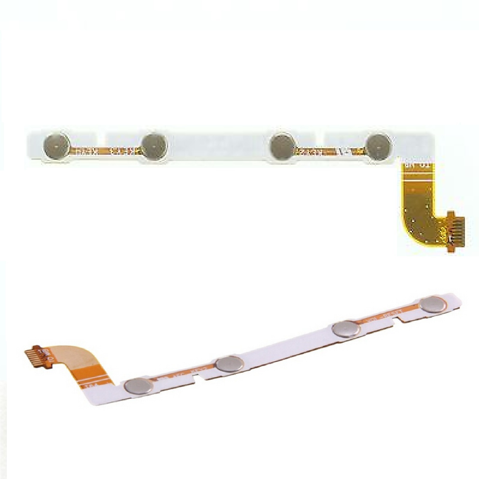

note: i found one which resembles the one i need, however its not an exact match and the buttons are spaced differently: **broken link removed**
great thanks! that's it! send me your paypal so i can send you something to buy a beer on me :)
