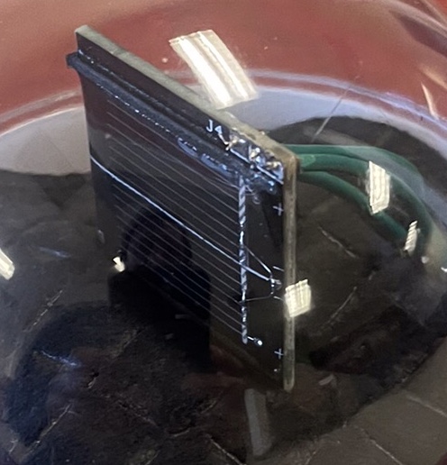

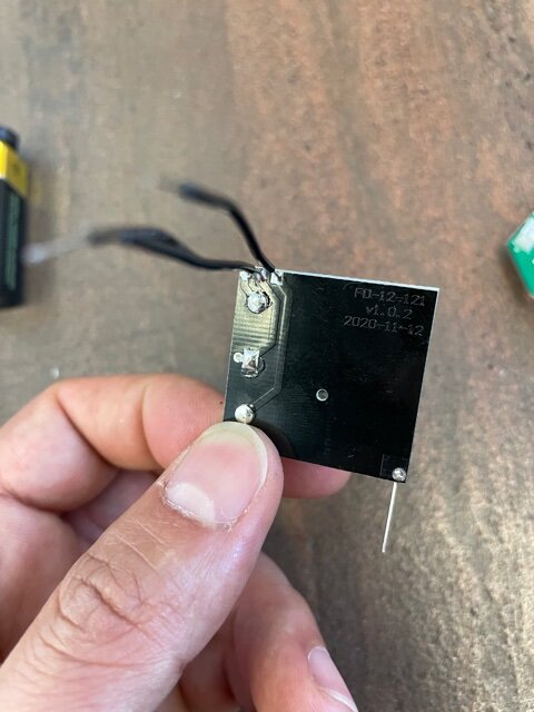

I'm not sure if this is the right section to post in but I'm looking for some guidance on what type of part this is so I can do more research.
This came out of a huepar laser sensor for a laser level like you would find at a home improvement store.
The front has a field of wires going horizontally, split into two fields, above and below the middle line. It detects when the laser level is hitting above, below or right on the line.
There are three connections at the top that I believe are: (+) for top field, (-) ground, (+) for bottom field. There is also a connection at the bottom that is ground as well. I assume the circuit measures the difference in voltage generated by the top and bottom fields.
The dimensions are about 1.25" x 1.25".
I would like to know what type of component it is so that I can start my research and design a custom circuit using this.
Short of identifying the part as a whole. Would anyone know what type of wire like the ones in this sensor would generate a signal?

Looks like a small solar cell to me.
Agreed, just two sections with common negative and separate positive connections.
Directly comparing the two output voltages will show how well centred (or not) the beam is on the mid point of the two cell sections.
(The "wires" on the surface are the cell electrodes, that connect to the silicon layer, the active material)
It looks to be a low cost equivalent of a position-sensing or segmented photodiode such as this:
