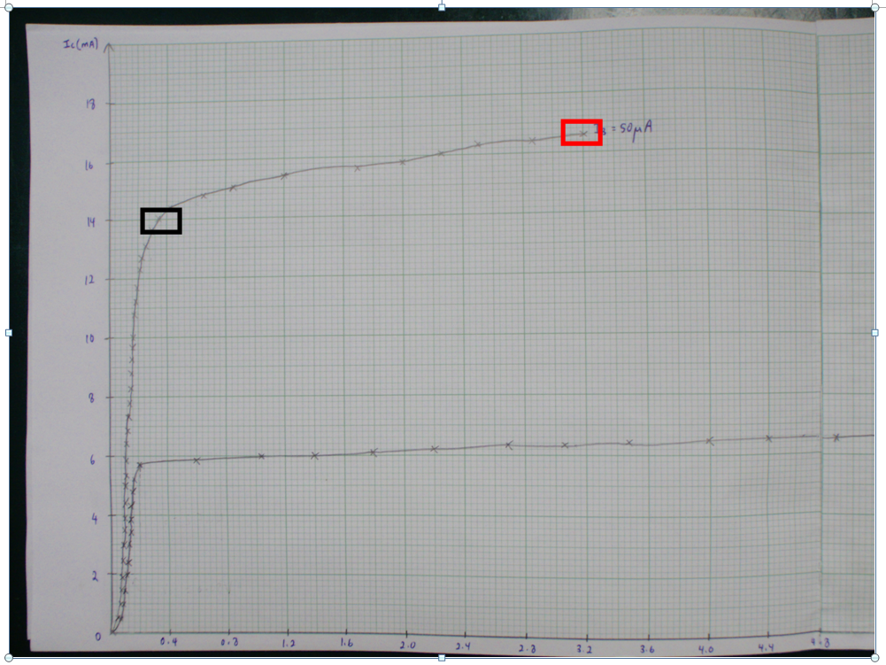

i am doing an experiment on the dc characteristics of the BJT and have drawn the output characteristic curve for values of IB=20uA and IB=50uA (Refer to attachment)
In order to find the beta of the transistor, I take Ic(sat) / Ib.
Referring to the 2 points of the graph i have circled in the attached pic, which point should I take for Ic(sat)? The point where the curve starts to become horizontal [black box] or the point right at the end (highest point of Ic) [red box]?
help is extremely appreciated. thanks=)

The area where the black box is located is a better approximation than where
the red box is. The red box shows an area where the transistor has already
been forced out of saturation. The black box shows an area where the transistor
is just starting to be forced out of saturation.
Some oscillators use this principle to oscillate. The collector current starts to
increase more and more and eventually it reaches the point at that black box
where it starts to come out of saturation and so the collector voltage starts
to rise suddenly and that causes another part of the circuit to shut off the transistor
completely, and that's half of the oscillation cycle.
Some of those small LED booster circuits use this principle to boost the voltage
needed to drive a white LED.
At the red box the transistor is a linear amplifier with a base current that is very low (its beta defines its collector current/base current).
The black box is where the transistor is almost saturated but its collector-emitter voltage is too high because its base current is too low.
The datasheet shows that a little transistor saturates best when its base current is 1/10th the collector current which is not beta.

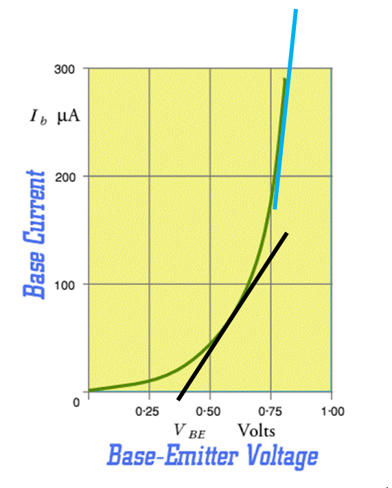

i have another question. referring to the pic attached of Ib versus Vbe..should i calculate the small signal input resistance by taking the gradient at the black line or the blue line...i have strong feeling its the black line because its is only then where the signals are "small"..is my assumption correct?
Likewise, As for the dynamic output resistance on the output curve, I will take the gradient at the ohmic region of the curve as it is also at the region where the signals are "small"?
thank you
You are looking at the dynamic impedance of a diode. A transistor input impedance is its internal Re plus any external RE times its hfe.
I simply look at the input impedance graph in the datasheet for the 2N3904 transistor.
assuming that there is no external RE, is it correct to just obtain the impedance by finding delta Vbe/ delta Ib from the input graph
I read that for this purpose, the value of Ib is obtained by setting the value of Ic to a fixed value (say 5mA)
why is this so?
The input impedance of a transistor drops as its current is increased. I think its input impedance is much higher than for a diode.
why is this so?
I see ... so is 5mA considered a typical value used for analysis?

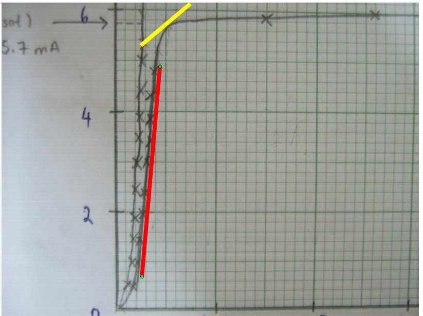

referring to
The output resistance of a common-emitter transistor is its collector resistor because the collector is a high impedance current source. The Early Effect causes a collector to have some measurable resistance.
and also:
The output impedance of a common-emitter transistor is valid only when the transistor is linear, not saturated and not cutoff.
Through graphical analysis, I evaluated the change in Vce/Ic to find the output resistance which supposed to be 1kohm (The value of Rc)
[refer to attached pic]
When i evaluated at the point of the yellow gradient, i yielded 200ohms but when i evaluated at the red gradient, i got 20ohms...when i evaluated the gradient across the saturated (horizontal) line, i got 4000 ohms...
which is the correct point that i should evaluate to get the correct output resistance? (1000ohms)
thanks

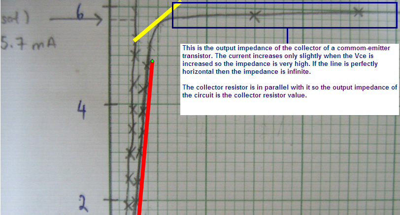

The collector impedance of a common-emitter transistor is very high.

i have one final question:
after evaluating the gradient at that section i obtained a value of Rout=6432 ohms..
is there any way i can validate this value of Rout theoretically without considering the effect of the collector resistor in parallel....which then reduces the resistance to the value of Rc...?

On your first graph I calculated that the collector current increased from 5.8mA when the collector voltage was 0.4V to 6.6mA when the collector voltage was 4.4V. Then the collector impedance was 5k ohms.
The collector resistor is about 807 ohms (5V/6.2mA) if the supply is 10V.
