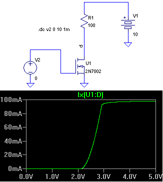

I don't see anything wrong with the device curve (Ids vs Vgs), but the "load line" doesn't make sense. Class A operation does require biasing somewhere near the middle of the curve, but I don't know what the straight line represents.
Thank you very much Alec and Ron.
Ron,
Thanks for the simulation.
I guess that the straight line was an approximation.
BTW, which simulation tool did you use?

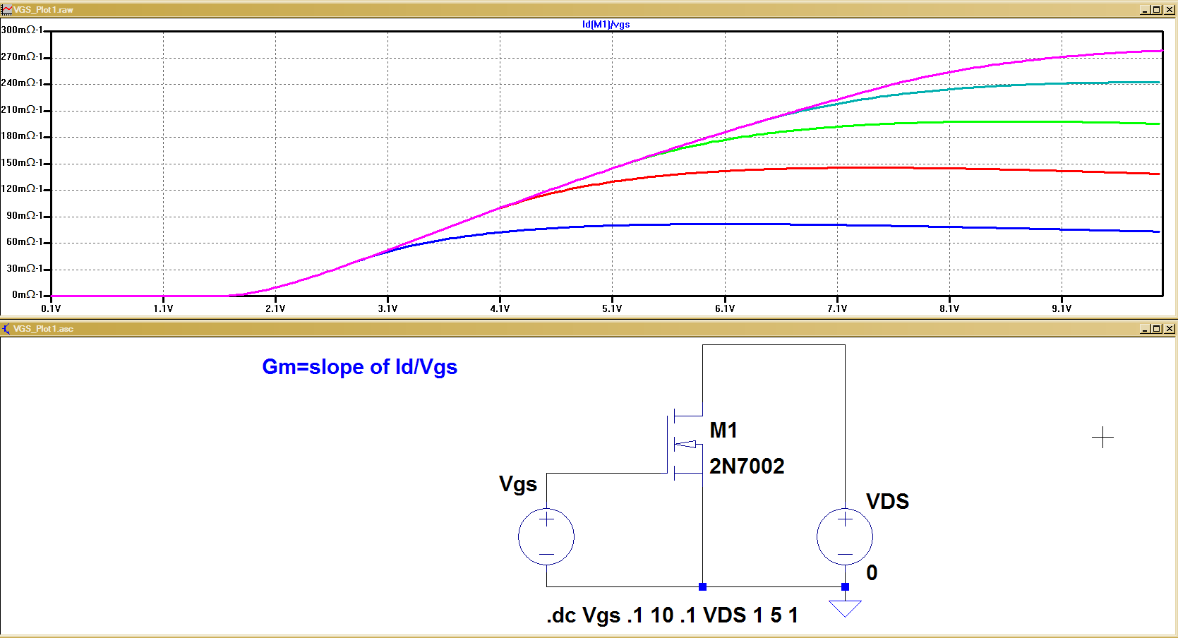

I was looking at this LTS Sim yesterday for another OP,, posted for reference.:D
that looks more like an Ids vs. Vds curve, at one particular value of Vgs
(NOT Ids vs. Vgs at one value of Vds)
and yes it is taught in colleges...it is taught in every basic electronics course
I think you're wrong. Ids vs Vds with fixed Vgs does not have a threshold voltage. Look at the curve I posted in post #7. It looks like that.
