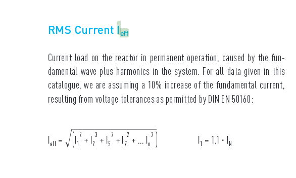

anyway the question, What is the IEFF on a electrolytic capacitor? for example the one I have in my hand (now discharged with a resistor screwed across its terminals) say's I EFF(100Hz) 19A (50C)
Look here.

I think IEFF is justa fancy word for ripple current, if you were using a cap as a smoothing cap in apsu then the ripple current is an important factor, if you exceed it the cap will heat up and bang.
