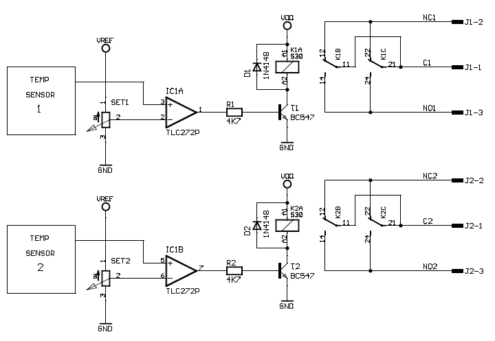

Hi plasticcat,
you're overcomplicating your project.
If you have two temperature sensing circuits why not have them energize their loads independently?
Normally a dual OpAmp configured as comparator will do the job nicely.
Here is a basic schematic.
Boncuk

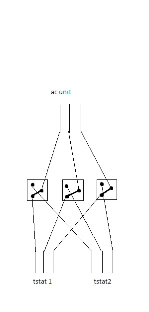

what im trying to do is lets say a house has a upstairs and a down stairs, with one air conditioner, a thermostat for up stairs and downstairs, think of the thermostat you have in your house on the wall
each t stat has 3 wires i need to choose between ( heating, cooling and a fan ) i cant have both thermostats sending information at once so i have 3 relays to switch them, depending on if the relays coils are enegized, now i need a timer circuit that alternates them every 15 min if both are calling at once, so basically if normally closed thermostat calls first, then normally open thermostat calls second and starts a basic astable timing circuit the first cycle will be on therefore giving the normally open thermostat priority because the coils will be energize, its supposed to work by giving what ever thermostat called first 15 minutes then cycle,
here is a diagram of how the relays are set up and the coils are gonna be controlled by the timing circuit and the timing circuit is gonna be turned on when any 1 wire on each thermostat has power at the same time
basically the relays switch complete controll of the a/c unit depending on if the coils are energized or not

Ok I get it. You just need two 15 minute timers, and allow each to disable the other when active. It's not hard to do with a simple 555 timer, or other suitable timer device. Don't use an astable configuration, just configure it as a monostable, or one-shot with an active period of 15 minutes. If you need help making the configuration, I could scrawl out a schematic later, when I have more time. Or else look up "monostable timer" or some such text on google to see how it's configures. Or else look at **broken link removed**

i can build the timers thats easy, but my main problem is when the timer circuit is first started the first cycle is on, but what if the first t stat that is called needs to be in the off cycle, thats where my second timer comes into play
If you use a monostable, it won't start until it's corresponding t-stat calls. Both timers will be just sitting and waiting until someone calls. Then it will start and run for 15 minutes, then go back to sleep until someone calls again.
However, at the end of the 15 minutes, if the t-stat is still calling, you'll get a little "glitch" if that t-stat is connected to the NO pin of your realy. You don't really want that, so I guess you'll want to leave the relaly on until the t-stat stops calling.
no see if only one is calling it will run for ever there is no need to time it, the timing is only when both of them are calling because then it needs to "share" the one a/c unit if only one or the other calls it can run for ever no need to share, basically what im trying to accomplish is if 2 of them call, i need the one that called first, to get its 15 minutes first reguardless if its on normally open or closed part of the relay, and i need astable so it retriggers the cycle of on and off forever untill one of the thermostats stops calling
The function of each t-stat leg should be:
Output = calling OR Timer. Where timer is a monostable. That gets you where you want to be.
