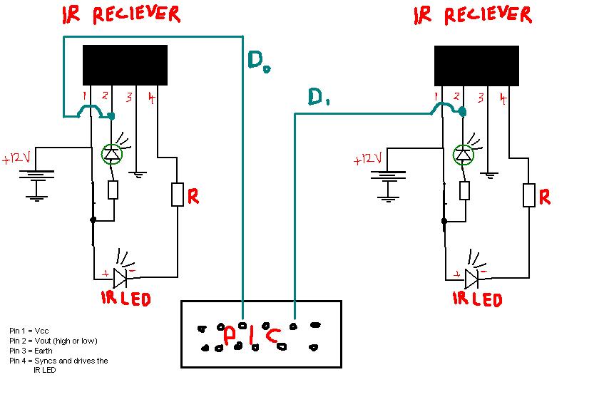

cyprio7
please note that for simplification iv only drawn 2 "sensor things" which provide two outputs D0 and D1 in this diagram, however in the real circuit there are 8, and which range from D0 to D7.
ok heres the purpose of this circuit. threre is an IR transmitter and IR modulated reciever, which drives the IR transmitter. I am using this circuit on a robot to detect objects that the robot may collide into..... i therfore, bounce the IR signal off a wall for example, then it is recieved at the receiever.
When the IR signal is recieved by the reciever, the reciever gives out a "**LOW**" output at its Pin.2. When it ISNT recieving the IR signal it is giving out a *HIGH* at Pin 2.
The normal LED which is circled in green, lights up when pin 2 is low, this is because pin 2 is low, but the other end is 12V, therefore current flows and the LED lights up. When pin2 gives out a high, i.e 12V, because the other end is 12V and ther is no potential difference, no current flows, therefore, the LED doesnt light up.
Now, when i dont connect Pin2...... i.e the wires D0 and D1 to the PIC, this circuit works PERFECTLY. When nothing is detected, Pin 2 gives out a HIGH and the LED isnt on.. and if it detects something, Pin2 goes low and the LED comes on.
The problem..... As SOON as i connect D0 and D1 to the PIC, or emulation board the problem starts. When nothing is detected, all LEDs are off, however, if ONE reciever detects something, and it makes the LED light up, EVERY single LED lights up, not just that one!
Does anybody know what could be causing this problem?? remember, when i dont connect D0 and D1 to the pic, the sensors and LEDs work perfectly and light up when they are supposed to.
any help would be REALLY appreciated... im going mad over this

wrong wiring!!
Your connections are wrong.
1. pin 2 can 'never' be low, according to your wiring.
2. The IR receiver would have burnt out by now.
3. The PIC will also burn out, if it is'nt already.
The pin 2 is connected to +12v via R and LED. This means a constant 12v-1.8 =10.2v is available at pin 2. the same 10.2 v is connected to the PIC. This 10v will play havoc with the various ICs.
Please check the Data sheets of the IRRX and rewire, with all new components. The present components may be french fried by now :!: :!:

That's a good point... you can't drive a 10v logic signal directly to the input of a PIC that is running at 5v or so... it's going to trip the internal protection circuitry (such as ESD protection diodes) and I wouldn't be the least bit surprised if it behaved oddly, or if it died completely :lol:

His IR receiver wiring is correct and is working. He told us that.
In fact, it can because green LED lit up. Why not?
The only way the IR receiver would have burnt out is PIC driving current into pin2. But as pin2 is connected to PIC input pins, this cannot happen.
Yes, there is 10.2V to the PIC but this is current limited by the LED and series resistor. The excess voltage /current is fed to the PIC input pins which do have protection diodes connected to the supply rails.
So I would say 99% the PIC is still not damaged. Cyprio7 can tell us is the PIC already dead.
To Cyprio7, I hope you do now realised that you are connecting signals between different voltage levels. The easy method is to use large value resistor(100K) to connect the IR receiver output(Pin2) to the PIC's pin(relies on the PIC protection diodes working) or use 10K series resistor with a 5V zener at the PIC input pin for each signal.

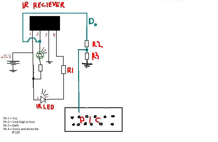

so, if i add 2 resistors like this to act as a potential divider.. it will stop a lot higher than 5v from appearing at the input pin of the PIC... and therefore might allow it to function correctly? if slightly more than 5V is applied does it make a difference? like maybe 6 or 7 V?

2. Why 12V and not 5V, which will save everybodys time, not to mention the PIC?
he has a point. A large number of microcontrollers work nicely at 5V. If I remember, some microcontrollers can heat up and/or malfunction if too much voltage is supplied to it. I'm using an 8051, and I only use 5V for it and it works nicely.
What voltages will the PIC port line see??
10V ...... GOD FORBID
I don't think that a direct 10V connection would work.
If for some reason, you must use higher voltages, at least have them isolated from the microcontroller. an optocoupler should work.
