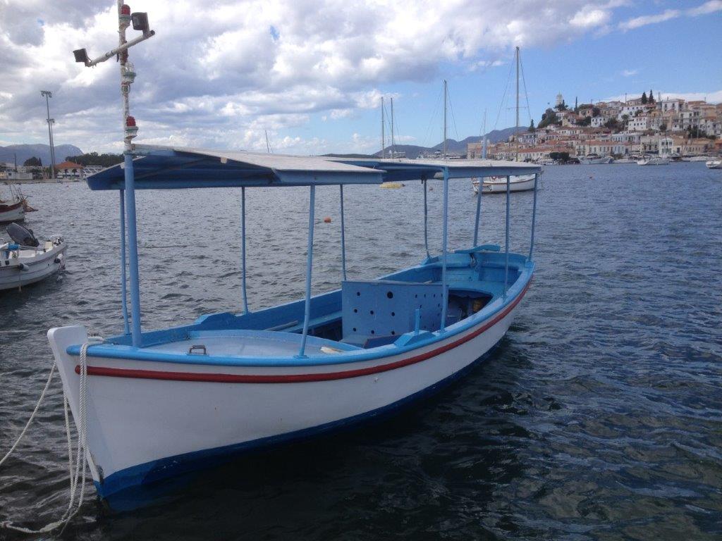

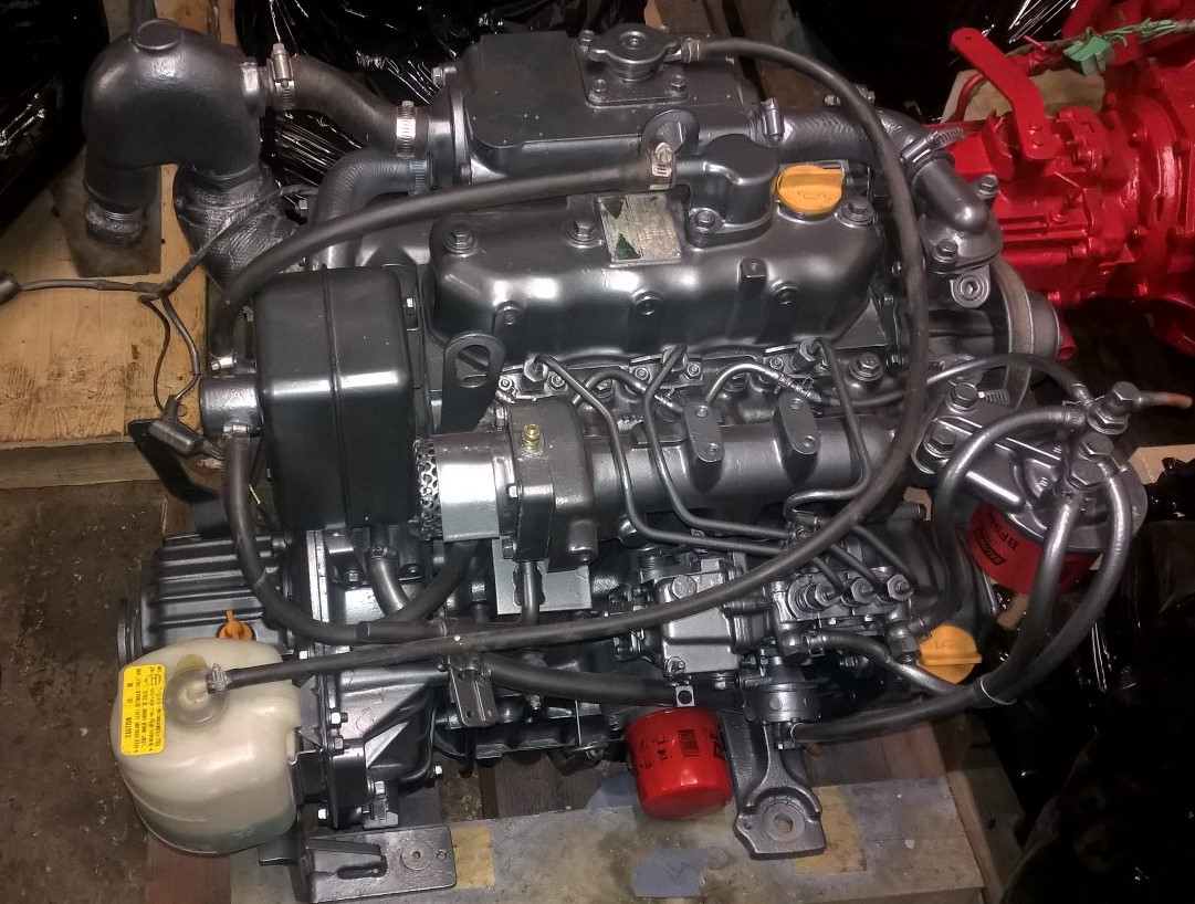

Thanks Guys, waterproofing and sealing is a great idea, and it's saltwater by the way, but when it comes to connecting the ignition circuit and starter solenoid would you do this on the start battery or house battery circuit?. Just leaving the 35mm cable only maybe from start battery to starter motor? Here are some pics of the boat (6m wooden) and engine (Yanmar 3JH25A). Just for interest I'll post some pics when she is finished
