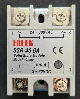

Hi, I have an IKEA wireless led power supply which outputs 24V DC / 54 mA current /10W max (model: ICPSHC24)
Challenge: I want to turn on a 220AC appliance when the led is on.
Unfortunately, the output current is too low to trigger a relay such as HF152FD, which would be the simplest and immediate solution.
Therefore, I understand I have to go with optocoupler, which I am not familiar with. In addition I understood that 24V DC is too high for octos.
I searched the internet for a circuit (the simplest as possible) but I didn't find something that makes me comfortable to implement.
Some suggestions? Thanks in advance.
A "Solid state relay" woudl be ideal. They have an input that feeds an optoisolator, and interal circuitry to switch a high current load.
This one should be OK up to 15 - 20A or so and will take about 30 - 35mA at 24V on the input terminals:
It will need to be attached to a metal heatsink if it's switching high currents, as it will get warm.
(I'd only trust the no-name types to around a third their supposed rating).

Do you want to turn the appliance on when the power supply is on or the LED is on? There are lots of suitable relays that are 24V if it's the power supply. Your power supply can output 24V at up to 420mA (0.42A) - most relays will take ~15mA. Link.
