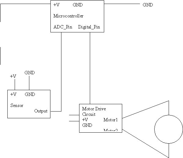

okay... i think the phrase 'circuit diagram anyone?' comes into play here (for a robot that follows 1 side of the maze)
This is something you would write into software. You could wire it with discrete components to make it behave that way, but it's not flexible and very difficult to make changes to.
You would wire up power to the sensor and the microcontroller, then plug the signal wire of the sensor into the microcontroller. The rest is programming so that the microcontroller behaves.
It might look like this image (connect all the powers wires to where they are supposed to go since everything needs power and I got lazy and didn't want to draw all the wires going from the batteries). Power lines are +V and GND
