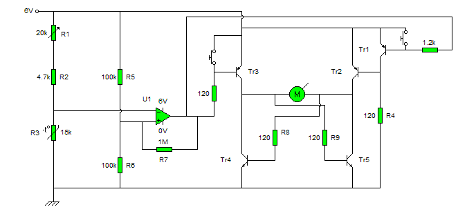

I have a cold frame that will open and close depending on temperature. I'm using a small gear head motor to operate it and two base model household thermostats to control the motor. One therm. is set to heat the other is set to cool, and when the heat one reaches a set temp it opens the cold frame, when the cold one drops below a lower set temp the cold frame closes.
I imagine that this could be handled with a simple circuit that could be made for $10.00 instead of all the expense of the thermostats.

You could probably make it cheap with an RTD type thermo sensor and a comparator, some drive circuitry, etc. But if you have a design already working, I'd just go with that.
Do you need to sense temperatures at two different locations, or is it that you want two different temperatures at the same location to generate two separate outputs?

Temperatures are sensed at the same location with two separate outputs.
The cold frame is a box 3 feet square about 15 inches high with a glass top that opens and closes. When the temp reaches 80 degrees the top needs to open so the seedlings don't cook. When the temp drops to 60 it needs to close so the seedlings don't get too cold. The sun is the only heat source so there is no heating element or anything of that sort being operated, just a 12v gear head motor (from a car window opener) being controlled forward or reverse as needed.

Here's an electronic solution.
The switches are limit switches.
Use an LM311 for U1.
It's a power guzzler with a huge standby current of >50mA.
If I wanted to power this from a battery, I'd use MOSFETs, and a micropower comparator, that way it could be run from a solar backed up battery.
You might be able to drop the battery requirement but then you need to be sure it will close the window at sunset, an additional voltage sensing comparator could be used for this but there won't be much light at sunset so you'll need a grossly overrated solar panel.
