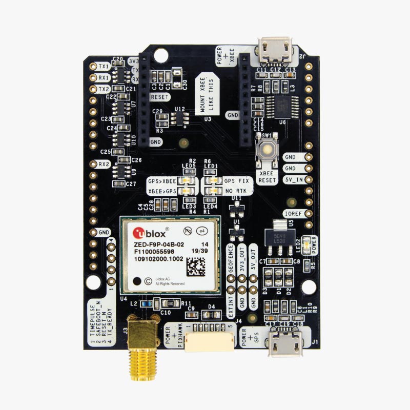

I'm looking for a replacement for my M8N module. Maybe this one https://gnss.store/zed-f9p-gnss-modules/104-elt0091.html (it seems like it can work independently, installed on acopter/drone?), or this one https://gnss.store/zed-f9p-gnss-modules/101-elt0089.html would be suitable replacements for the M8N? Or would I still need to have a ground station?
I have just started learning about RTK technology but would like to order the necessary equipment. Any information would be greatly appreciated... Thanks

RTK needs a ground station - somewhere...
If it's close to you, you get better accuracy, but using a public one miles away is better than nothing.

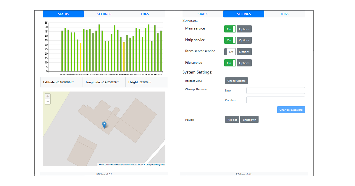

I've set my own up, as I was already using a Raspberry Pi & a ublox gnss board with outdoor fixed antenna as an NTP reference, so adding the RTK part was quite easy.
I used this:
with the Ardusimple ZED-F9P development board
(Though mine cost a lot less, from another reseller!)
