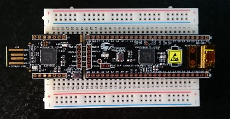

The boards that will do all 8 channels in post #10 (you only need 1 board to do the 8 channels) :
CY8CKIT-059
CY8CKIT-043
Shop them, I see the 059 board as low as ~ $16, which is a much more capable target chip.
Note the boards have two PSOC chips on them, one the target, the other for debug/programming.
You snap off programmer when done with design. Note it can be used as another stand alone
design, but indepth debug facility no longer present so one debugs writing to ports. Also
it has very limited I/O, but still quite usable for some designs.

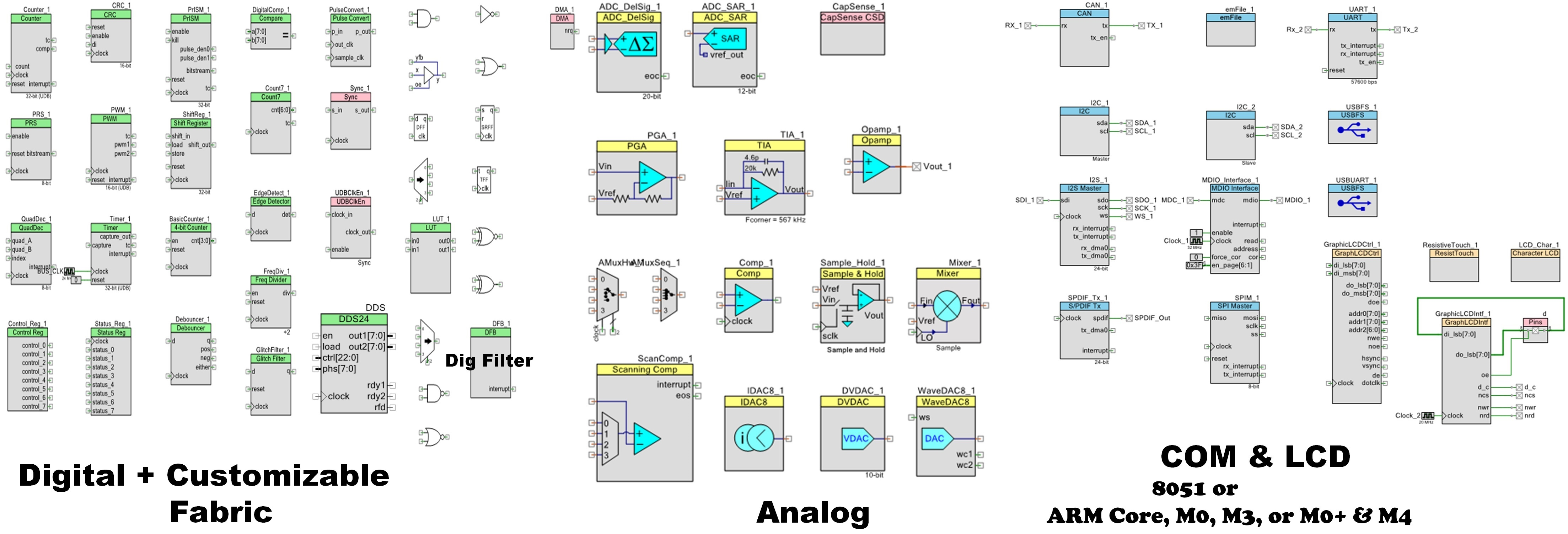

The design in post #10 you write no code, although you do a build and then hit program button
as tool generates setup code for the target PSOC. Normally one does write code but many designs
can be done codeless due to their simplicity, as this design is.
The resources in the target chip, multiples in many cases, that you can also use are :
