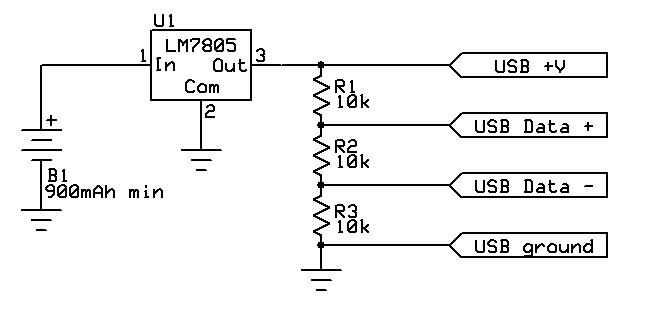

What I have set up now is an ICL7663 LDR adjusted to 5V, the output of which goes through a 100µH RF choke which seems to be doing a pretty good job at muffling the noise, but the noise is still there. The attached circuit is of what I currently have set up to charge the iPod.
Some of the things that I have tried are:
-standard 7805 regulator
-LDR regulator (currently used)
-series regulator
-shunting regulator
-low pass filter before regulator
-low pass after regulator
-high pass before regulator
-high pass after reg
-band pass before and after reg
-charge pump to isolate the iPod from ground (very desperate attempt)
-filter caps (which made it worse, or it wouldn't charge at all)
-filter inductor (best by far)
The only thing that I haven't tried yet is a switch mode power supply, but I have tried using a 555 timer and a MOSFET to supply the regulator with a second noise source at a much higher frequency than the audible noise that is driving me insane (the 555 was putting out about 220kHz). I don't have much experience with switch mode power supplies, so can you give me a summery of the pros and cons of these power supplies?

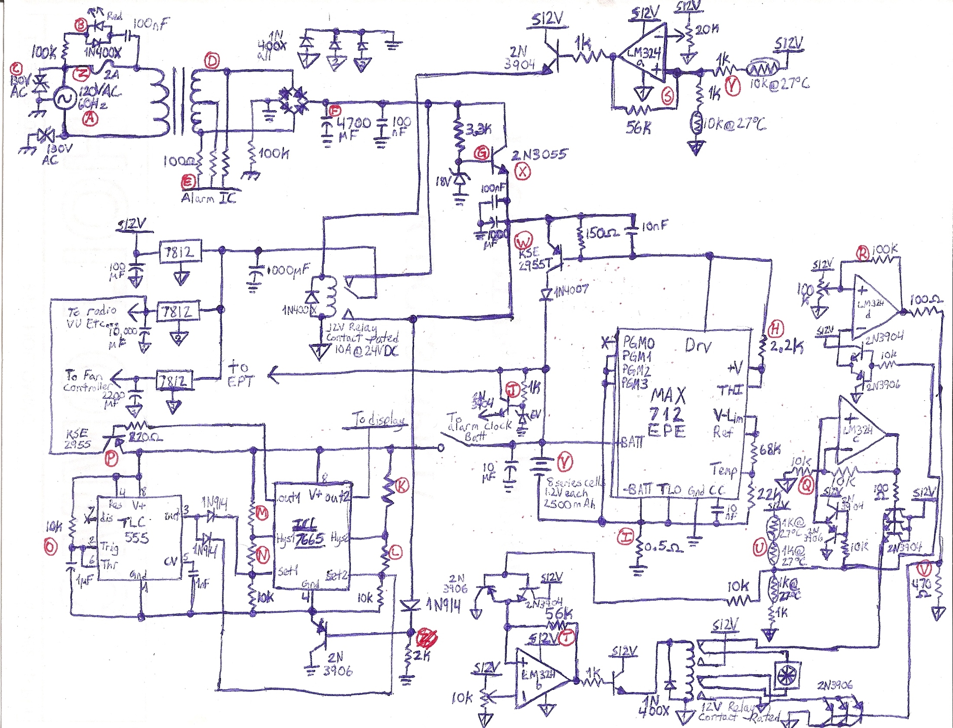

I have attached the schematic of my current power supply, the only change that I have made to it since it was made is that the output of all of the 12V regs are connected via a 100Ω 10W resistor, and no that's not the cause of the problem. The charger is connected to where it says "To radio, VU, etc..."
I will also give the shielding a go, though I'm not too optimistic. I also thought about adding a series inductor to the input of the amp since it has an isolation cap but no inductor, do you think that might help?

Wow, I must say... I've seen a lot of schems in my time, and hand-drawn one are rarely that clear and readable!
I have only glanced at the schematic, which I may look at more closely later on, so right now I'm just going to blurt out some thoughts.
Firstly: Just checked wiki about the 5th gen nano. Uses a TFT (lcd) display, LED backlit. TFT's tend to be rather quiet when compared to the new OLED displays - which have to multiplex much higher current since they are powering the LED's as pixel, not just liquid crystal segments. So, I'm thinking the display itself is probably fine :)
Seems you have tried a LOT of standard methods to get a 'clean' supply, but I am still unsure of your basic setup. I mean, you have a nice schematic there, but is your amp powered separately form the iPOD? Does it charge the iPOD? I see a max712 in there, with some batteries, which I'm guessing is for portability (the 712 being a cool on board charger for those batteries) ... is this what you meant by 'putting it on charge'? Or did you mean.... you plug your iPOD into the amp, whilst the iPOD itself is charging?

The thing that strikes me about that schematic at first glance is the base resistor for the 2n3055 is 3.3k. Considering the gain of a 3055 this seems rather high. Putting it into a simulator gives me very poor regulation/no regulation at currents over around 240mA.
Changing it to a 1k resistor gives regulation to around 700mA.
Just a thought
Just a thought
Your thought has been noted, and taken into account. I also noticed that adding a 100nF capacitor to the AC input of the bridge rectifier really helped to reduce the noise.
