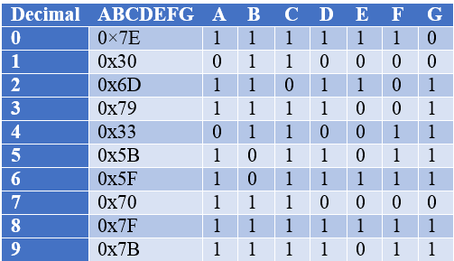

Hey guys i've been tryna building this two button counter but it doesn't work. Displays change at the same time and they showin other things oher than numbers. Anyone has a idea why it is like that?? (Display is common cathode btw)

#define buttonplus PORTCbits.RC0
#define buttonminus PORTCbits.RC1
#define display1 LATAbits.LATA4
#define display2 LATAbits.LATA5
char ones = 0, tens = 0, number = 0;
const char digit[10] = {0x3F, 0x06, 0x5B, 0x4F, 0x66, 0x6D, 0x7C, 0x07, 0x7F, 0x6F};
