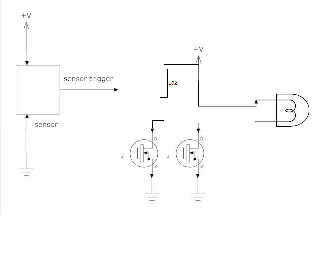

Here is where I'm currently stuck. I know there must be a simple answer, but I not seeing it.
This is a very basic idea (using a crappy smart draw schematic) of what I have.
The problem is that the sensor trigger is ground.
If it was not ground and actually gave me a voltage then I would just hook everything up, the sensor trigger line would drop voltage across the gate and it should work. But I'm not sure how to do this with the sensor trigger line being ground.
Invert the signal. The 10k resistor can be just about any value ± an order of magnitude.

mneary,
Thank you for taking the time to actually draw that up, but I'm still stuck on the fact that all the sensor trigger will do is ground the gate on impact.
