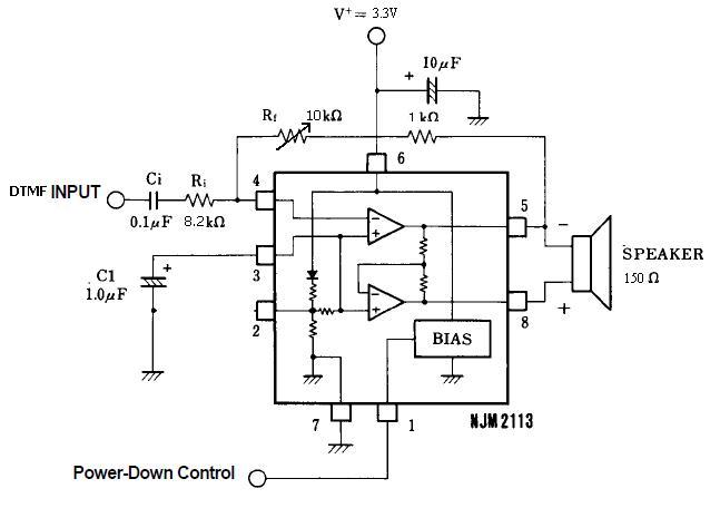

Hi guys,
I have a problem with my audio circuit. I use NJM2113 as my audio amp and a 150 0hm speaker. I could not get a good tone from it. But when I change an 8 ohm speaker it does produce a good tone frequency. Is this the result of impedance mismatch?

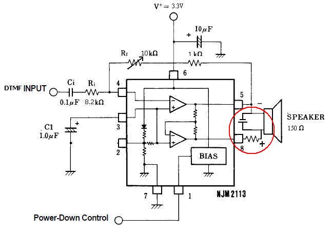

I'm actually using an analog phone to detect the dtmf tones. Only the 8 ohm speaker is recognized but not the 150 ohm. I believe the njm2113 is able to support 8-200ohm of load impedance base from what is written in the datasheet. But why is it that it doesn't output the exact tones for the 150 ohms? It sounds good though as compared to the 8 ohm speaker but I could not get any response from the decoder.

I think we're getting somewhere now that you're providing this key information. Try a low pass filter. Place 150 or 180 ohms in series with the speaker, and 0.22µF (or a pair of 0.1µF) directly in parallel with the speaker. These are rough figures.

I already did your suggestion. I already updated the circuit diagram. But I still wasn't able to detect the tones. I also observed it under the software decoder and still the B tone is higher than the A tone.

I can only suggest more capacitance in parallel with the 0.22uF I already suggested.

Maybe Ci is too low a value, how about a 1uf cap?
I see that you copied the data sheet circuit, so maybe I am wrong, but I am thinking the cap value may depend on mic used.
