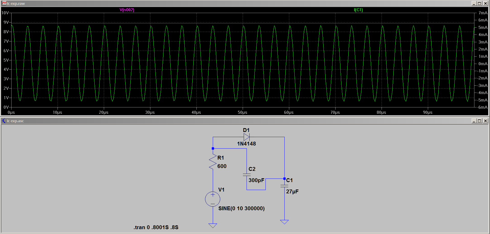

i measured capacitance of load=27uF then calculate load impedance that will be Z=R+j/wc=11.9+j/(2*pi*f*c), and |Z|~=12 ,

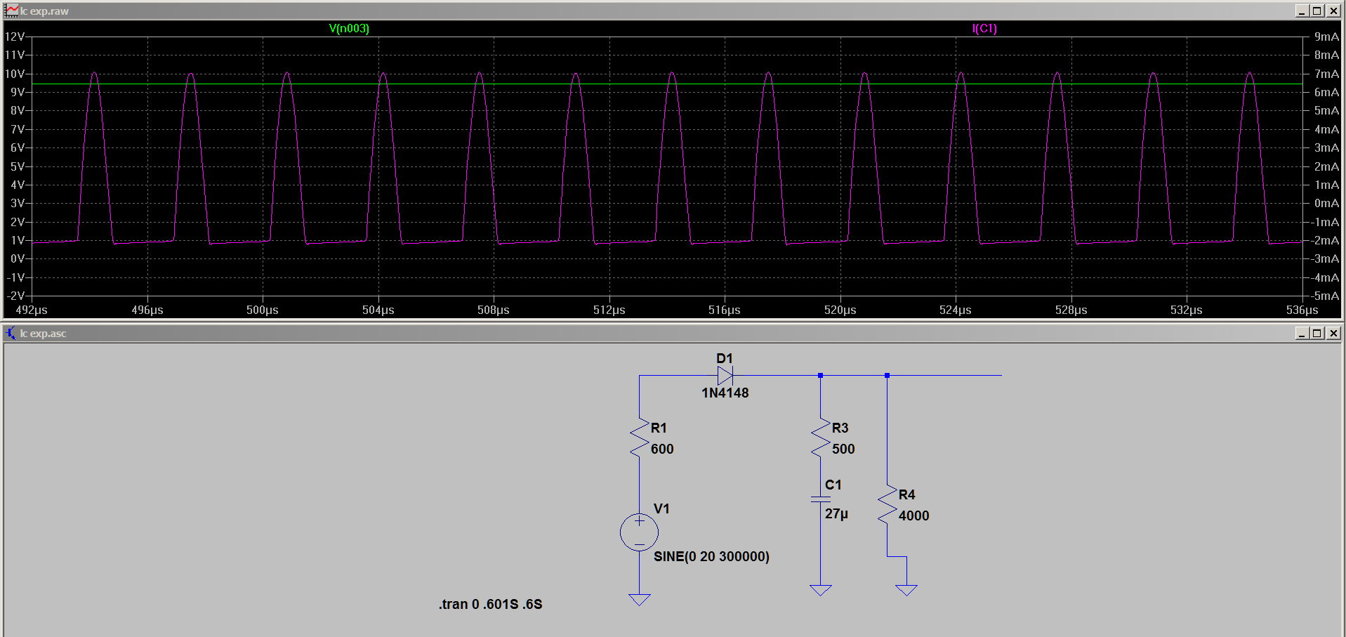

Here is one thing you could do. The current through the capacitor averages 3 mA and the voltage across the capacitor is almost 10 volts. The values can be adjusted by changing the resistor values.
thanks a lot, what about negative values i need whole signal,
or...can i use op amp as buffer in this frequency?
Hi. I'm not sure where you are putting that 100 ohm resistor, or why you are using it. The 600 ohm resistor in the schematic I provided is internal to your signal generator and should not be added outside the generator. The node on top of the 600 ohm resistor is one of the two output terminals of your signal generator. The other terminal is the shown connected to the bottom of C1.
no no , i didn't use 600 ohm i know about it, but because of voltage dropping and changing waveform of voltage across the load i used 100 ohm resistor series with load.
I'm sorry. I think I am just not understanding very well. Is everything fine with the circuit I posted except for the very small amount of voltage ripple across C1? If so, it cannot be removed entirely. You cannot have a varying current through a capacitor without some finite amount of voltage ripple across it (that I know of). What is the maximum amount of ripple voltage you can tolerate? I think I can do something to reduce it, but not eliminate it. An external power source, such as a battery, might be needed. Is that the only problem remaining and is a battery or batteries okay to use?
let me explain more....i have a plate with two small electrode inside it such a capacitor(d=1cm) and fill with salt water. (this is my load) Its capacity was measured using LC meter show 27uF and less...now i want to pass about 3-5 mA current and have about 5-10vpp across this load....my signal generator have 600 ohm impedance....voltage will drop across the load when connecting to generator
