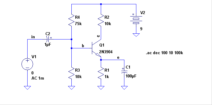

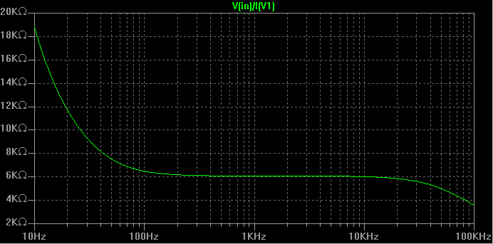

Zach, I drew this simple one-tranny audio amp as an example. I'm driving it with a 1 millivolt AC signal, swept from 10Hz to 100kHz. Below is a plot of V(in)/I(in) (remember Z=V/I). Keep in mind that we are in the frequency domain here, not in the time domain like you see on a scope. Notice that the units on the vertical axis are in ohms. This is the input impedance of the amplifier.
At midband, it is about 6kohms. This will vary with the beta of the transistor, but will always be less than 8.8k (midband), because that's the equivalent resistance of the bias network (R4||R3). At low frequencies it goes up because of the 1uF input coupling cap. At high frequencies it goes down because of the input capacitance of the transistor.
This may still be baffling, but it's basically the same idea as an ohmmeter, only it's AC instead of DC. You apply a voltage and measure the current, or you apply a current and measure the voltage, then calculate V/I.
