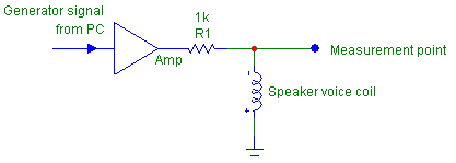

k7elp60 said about measuring the impedance with a DMM. i have always been inconfident in doing that. what i know is that a speaker is made up of a coil (an inductance) which is true (i guess :) )
can i measure the impedance of a speaker with a DMM. i dont think so. how do u measure the impedance with a DMM
The constant Current Method
You can measure it 'near enough', measuring the resistance, rather than the impedance will usually make it read lower than it is. So measuring an 8 ohm speaker may read 6 ohms - but because you know it's going to either 4, 8, or 16 - you know it's 8 - with the few rare exceptions (like 32 ohm) of course :lol:
Using a similar method to that above, you can feed it from a 1KHz sinewave source through a known value resistor - by measuring the signal voltage at either end of the resistor you can calculate the impedance. If you use an 8 ohm resistor, and an 8 ohm speaker, the voltage at the input should be double that on the speaker.
