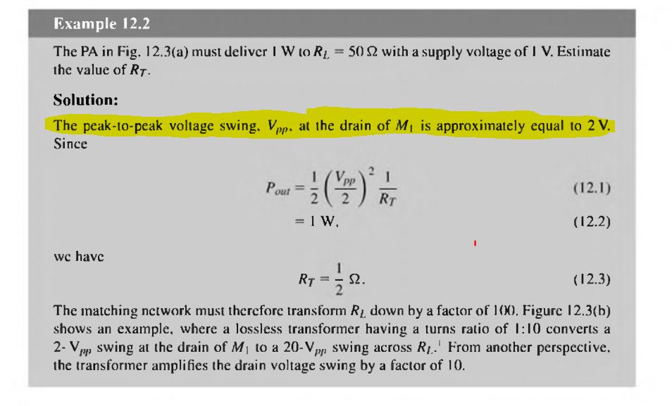

Please help me with this section in my textbook about power amplifier. Could you tell me why Vpp = 2V in this case? Thanks.

Have you skipped the chapter about CS amplifier loaded by a inductance load? We have 2Vdd because we have a coil as a load.
Thanks Jony,
I don't see this chapter. Can you tell me some sites explaining about that?
