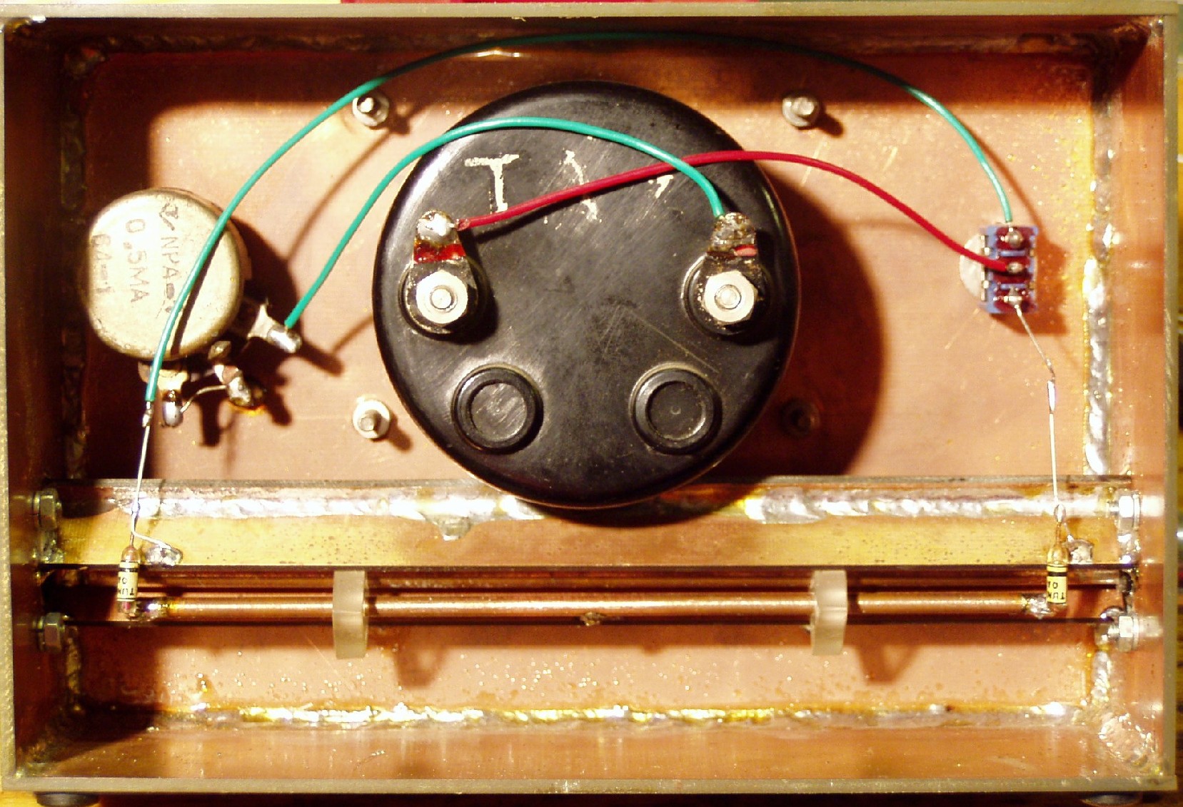

If You thinking about antenne-matching, build a simple SWR-meter like this. (I've build about 20 years ago...)

Although an s.w.r. meter can be very useful they tell you only that there is a mismatch but give no information about it other than its magnitude, i.e. that the termination is so many times higher or lower than the line impedance. No indication of sign or angle.
As an aside - I think it much more useful to calibrate them in power. The sensitivity of the parallel line type, shown in the photograph, falls with lowering frequency. Power calibration would therefore be valid over a narrow range.
With other power sensing schemes the sensitivity can be sensibly constant over a 10:1 frequency range.

Hello Sebi :D
If I am not asking too much, I would appreciate it very much if you could kindly send me your SWR meter circuit as I am very much interested in building on for me. My address is
ravi@ualink.lk

David - would you explain how the circuit works. This design is similar to others I've seen in ARRL and other publications. I trust that it (and other designs) does what you say it does but I don't understand how you separate the forward power and reflected. I look at other diagrams and just can't make sense of it. With a little help I'll catch on.
Thanks.
Let's have your email address stevez.
I have put a brief description on the web page.
