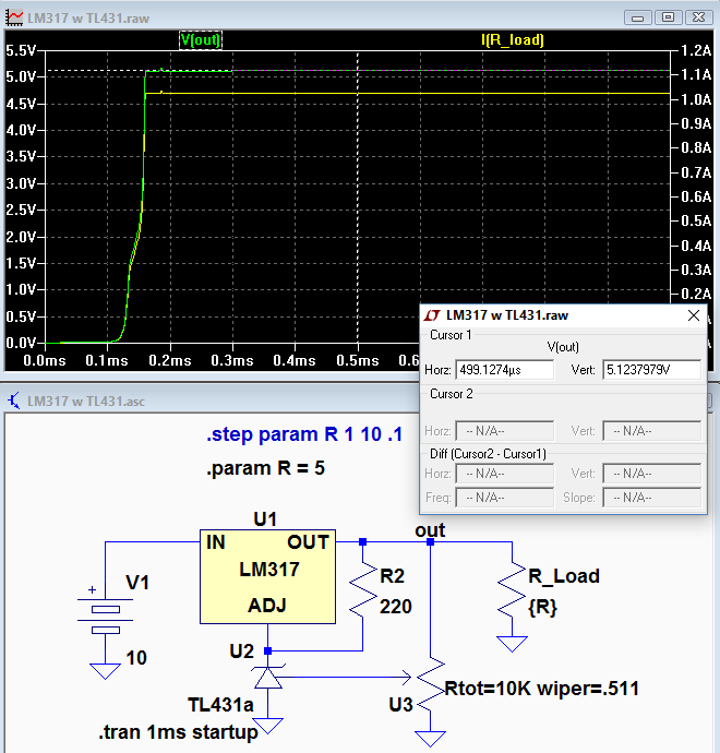

Doesn't the ADC have a separate input for the reference voltage?
If not, then below is the LTspice simulation of an LM317 with a TL431 reference to control the output voltage, so that the regulator's output voltage drift is almost completely determined by the TL431 drift.
And using the pot in the potentiometer configuration, as shown, will largely eliminate the effect of its temperature coefficient also.
  • LM317 w TL431.asc
Well, I built the circuit and the results were disappointing. The performance was worse than the NTC compensated LM317. Plus it took a long time (10 min) to settle after being heated. I think the To92 case of the TL431 holds heat longer and its real world performance isn't up to what you'd want.

Yes, it does seem to take some effort. I customised the circuit a bit by adding a 4.7K in series with the 47K NTC (NTC close soldered to centre pin) and got the variance down to about 4mV peak with significant hot air on the LM317 and also tested by driving the LM317 to 2 Watts dissipation with no heatsink (105°C). With just the NTC alone it was over correcting a bit.
I'll live with that as it takes two low cost parts I already have in the BOM and very little PCB space. The NTC solution has to be customized to match the LM317 voltage setting resistors which are dependent on the desired voltage ref. Also the PCB layout and trace thickness matters.
Edit: that's about 800 ppm. A long ways off the LT1021 spec. of 100ppm, but about 1/10th the cost and works as a decent linear supply.
Looking at making a DIY device that can profile an LM317 to match it to the circuit...... With such an approach obtaining around 1 or 2 mV drift is possible at low cost. It will be a matter of the DIY circuit advising which resistor value is required after thermally cycling the LM317 to determine the 'trim' required for it.
