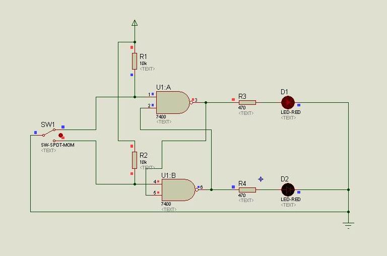

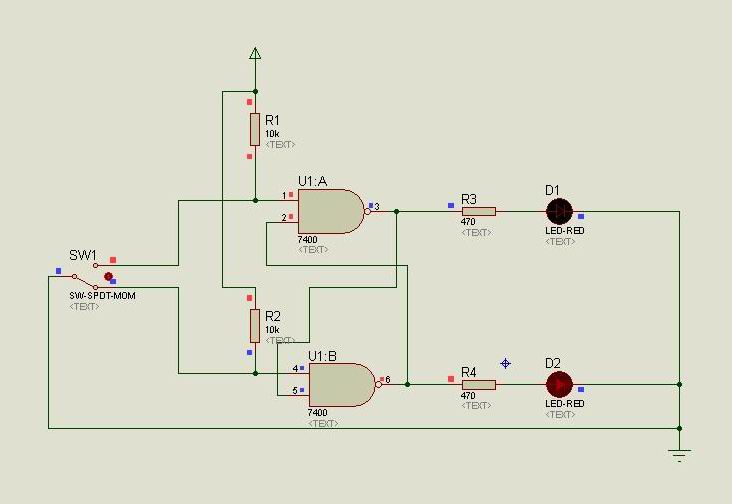

A simple switch debouncer / flipflop will meet your specifications, no need for a micro unless you need to develop things further.
If you do, what have you tried and what language did you use.
There is no such thing as no voltage unless you power the whole circuit off , you simply have to drive the output in one state H or L like most things digital.
Then why don't you use a simple flip-flop, hook the button to it via a shmidt-trigger (or similar for debounce), and use the outputs of the flip-flop to control whatever you are attempting to control?
Thanks, I forgot that it will always have a high if not low. I'll come up with a circuit and see.
"wp100", thanks for ths diagram. I was hoping a PIC might be simpler.
