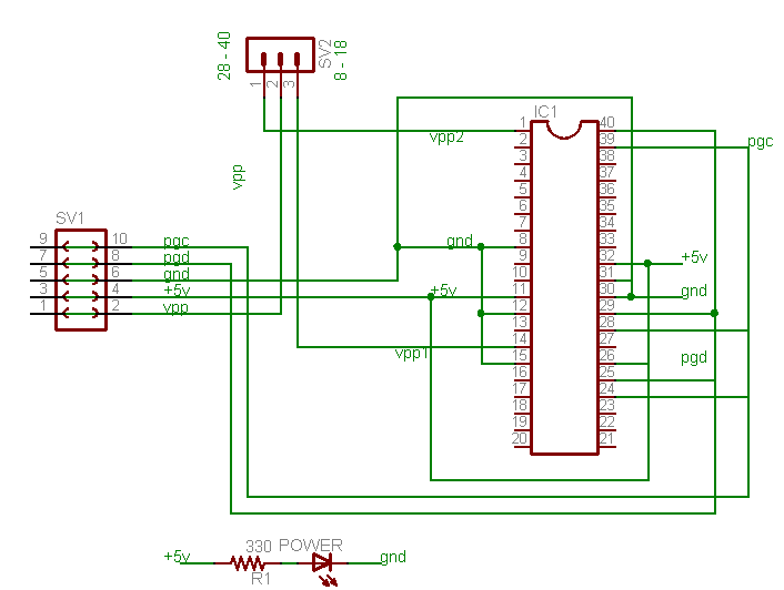

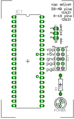

Please look over this rough schematic. This is my take on an adapter board taken off the firefly schematic. I hope this works. I just need it to program the 16F628A for now and don't need the "debugger". (not an EE) The hex code is already done, just have to load it up.
Oh, that 40pin is a 40p zif and the 3 pin header is for 8-18 pin pic's and 28-40 pin pic's for VPP.
thanks
If it's from the Firefly shematic it'll work, I like the 40,20 pin jumper idea neat.
PS it can program the 20pin PICs in the 18 pin mode.
PPS add a 0.1uf cap on the power, won't hurt.
Suggest optionally the 40pin VPP could be hard wired, the 8-20 pin chips will never see it. So a simple switch or jumper would be all you need on the 8-20 VPP.

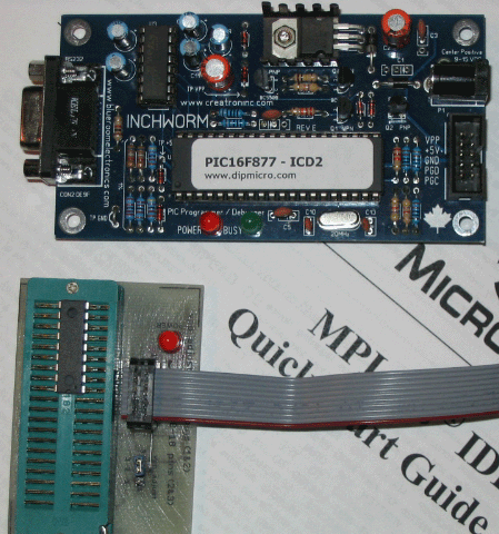

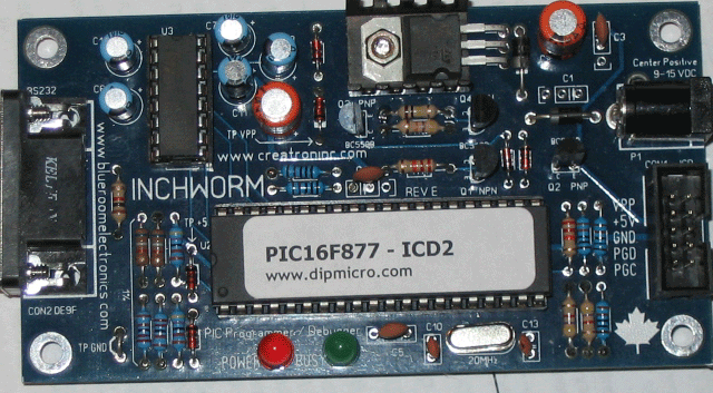

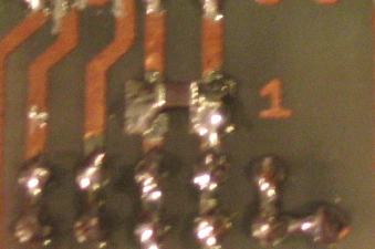

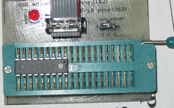

Finshed assembling my Inchworm
Well, I've finished my Inchworm - looks good even for a hack like me (non EE).
I also built an adapter board for maybe when I graduate to other Pic's (wishful thinking) schematic is on the first post, with the board. Oh yeah, William, I added a cap .1uf as you suggested - it's on the backside.
So with my new programmer and adapter bd I tred it out. Followed William's hello world instructions and got this failed message. HELP :confused: I've followed the instructions as closely as I could, but I'm still lost.
With the power applied, (13v dc wallwart) the power led comes on and my adapter led comes on (means that I got some power to the board anyway). I'm trying to program a 16F628A with this asm. I also have the hex file that has already been comverted.

Your Inchworm may not have the OS loaded, you must do this the first time you use your Inchworm. They come with the bootloader loaded and require the OS to be loaded too. Instructions are on page 7 of the Inchworm Assembly Manual.
Also MPLAB will not default to COM1 or COM2 when ever its run, you must select the COM port manually before you can connect. It will remember COM port setting when you are in a workspace.
Lastly if you're using a USB to RS232 adapter there are good ones and bad ones, if it uses the PL2303 chipset then use the driver on my site not the one that comes with it.
PS just noticed your PIC is inserted in the DIP socket in the wrong place, pin #1 goes to PIN 11 on the zif *you have it in pin 12
Well, I've followed the directions for downloading the OS for the Inchworm and no go.
This is the error msgs I get:
Connecting to MPLAB ICD 2
ICD0019: Communications: Failed to open port: (Windows::GetLastError() = 0x2, 'The system cannot find the file specified.
ICD0021: Unable to connect with MPLAB ICD 2
MPLAB ICD 2 Ready
ICDWarn0034: Please ensure that your system's serial FIFO buffers are disabled.
ICDWarn0054: MPLAB IDE has lost communications with the MPLAB ICD 2. Would you like to attempt to reconnect?
MPLAB ICD 2 Ready
Downloading Operating System
...Download Operating System Failed
ICD0286: Unable to communicate with ICD
MPLAB ICD 2 Ready
After hooking up the inchworm, I go into Programmer - selcect programmer -MPLAB ICD2
Then go into settings and change from the USB to Com1 and the fifo buffer box is unchecked. (reboot)
Then Configure - select device - PIC 16F877 no "A" is in the window.
Go back into Programmer - download ICD2 OS - it's a hex file ICD1020701.hex
The serial cable is hooked up and the power supply is attached as well.
help!! Still doing something wrong?????? or missing a step
Also what type of USB serial adapter is it? If it's a PL2303 based adaper force install the drivers on my site or it won't work.
Else check the crystal is mounted very slightly off the PCB.
The cable is a serial cable about 6' long. No USB adapter used. When I put the crystal in I used some "shims" to keep it off the board, so there is a small gap there and not touching the board or shorting anything out.
It was a kit from DPmicro so hopefully the boot loader was installed.
