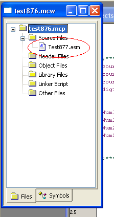

your program gave the same error.what is that problem?can you help me..
Debug build of project `C:\Documents and Settings\QUAKE\Belgelerim\mplabdeneme\deneme3.mcp' started.
Preprocessor symbol `__DEBUG' is defined.
Mon Nov 03 17:09:01 2008
Clean: Deleting intermediary and output files.
Clean: Deleted file "C:\Documents and Settings\QUAKE\Belgelerim\mplabdeneme\deneme3.mcs".
Clean: Done.
Build aborted. The project contains no source files.
Debug build of project `C:\Documents and Settings\QUAKE\Belgelerim\mplabdeneme\deneme3.mcp' failed.
BUILD FAILED

From the error message above, you have no source file in your project. You have to add the .asm file to your project. See attached.
