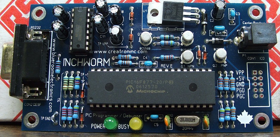

Hi Bill,
I promised you a picture of the completed board, so here it is - I've yet to decide what socket to put on it though, and I forgot to order a heatsink, so temporarily fitted the 7805 without one. I've tested it with MPLAB, and it uploads the software fine, and passes all the tests.
BTW, love the quality of the board, it's really nice! - I've kept the picture pretty large so people can see how good it is!.

Very cool Nigel !
whats the next step?
what have you loaded into the 16F877 so far?
Details ! details ?

Just the ICD2 software, I initially loaded the bootloader using my P16PRO40, then used MPLAB to load the 'OS' - I think it was the 18F version? - as I didn't have a target board connected it didn't really matter :)

Looks great Nigel, glad you like it :D
The 7805 only gets warm, You can use a #4 Nut & Bolt if you only plan on drawing a little power. There is copper on the top & bottom to help keep it cool.
There seems to be quite an interest in ICD2s. So I'm currently testing the 18F4550 USB version and if I can get it working I'll modify the Inchworm so you can build it serially and afterwards snap a USB piggback board on top.
Most USB ICD2s are the same speed as the serial versions (they use a USB to 232 chip).
The only fast versions use the PIC 18F4550, as it talks parallel to the 16F877.
PS I like the 5mm LEDs (I'll have to build one with a Blue LED)
Yes, it runs cold with nothing connected - it really depends if I want to use the ICD2 board to power target boards?, and (obviously) what current the target boards require.
I'm sure I've got exactly the right heatsink 'somewhere' - but exactly where is a different matter!.

I thought it was fine, I really only used the circuit diagram - with the silk-screened PCB it was all I needed.
Page 7 looks OK to me, it explains things accurately and briefly, seems to do all that's needed?.
