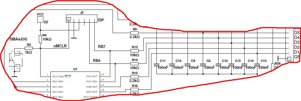

I'm getting the following error, when i try to program a pic18f2580:
ICD0161: Verify failed (MemType = Program, Address = 0x2, Expected Val = 0x0, Val Read = 0xD0)
I've tried 2 different devices and the error occurs on both. The eeprom is written ok. When i try to write only the config bits, it also fails on the second write...
Thanks for any hints!
Here is the output from mplab:
ICD0275:  Programming failed.

Hmm sounds like it's not connected to the target properly. How do you have it connected to the 18F2580? Is it in circuit or on a breadboard?
Hmm, I changed the final VPP cap on some kits to 4.7uF. It may be too small and I'll have to use 22uF like on the older kits. Do you have a spare 10uF 16V cap (just parallel it across)
i only have 15µ, but the error is the same.
I've also replaced it with a 22µ and more errors was the result :(
Hmm, do you have MPLAB set to automatically download new firmware? Which version of MPLAB are you using? Is the target running at 5V?
i've tried it with Mplab 8.36 and 7.6
Firmware download happens, when i switch to a different Mplab.
Target is running on 5V.
When programming it only writes 3 commands: first is correct, second is wrong and fails during verify, and the third is also wrong.
It's also the same, if i try to program only the configuration area.
i have 2 identical prototype boards here - on both the same problem...
the pic's are soldered, so i cannot change them
There is nothing connected on pgc & pgd (please see attachment).
Programming cable is 3" long.
The 1x6 ICD pinout is somewhat different than the Inchworms. Did you modify your Inchworm cable?
Yours is
VPP,GND,+5,NC,PGC,PGD
Inchworm is
VPP,+5,GND,PGD,PGC
