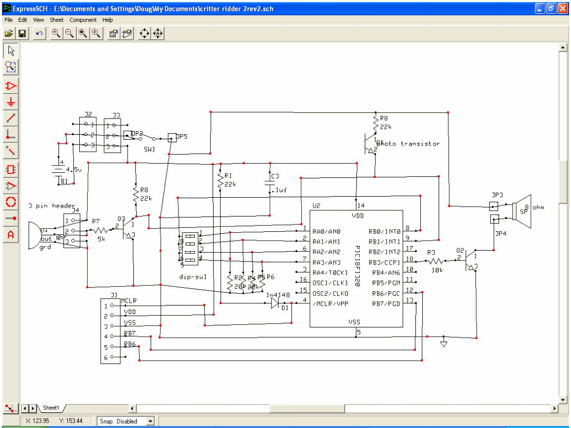

next thing I need is to have a way to make an OR statment.
have pin 9 (connected to PIR, triggers on LOW) then another pin that changes state. both pins trigger the PIC but pin 9 is disabled during daylight.
plan is a photo transistor connected to pin 9.
see schematic.
idea is the photo transistor disables the pin 9 during daylight and at night the PIR takes over and the timer is disabled.
