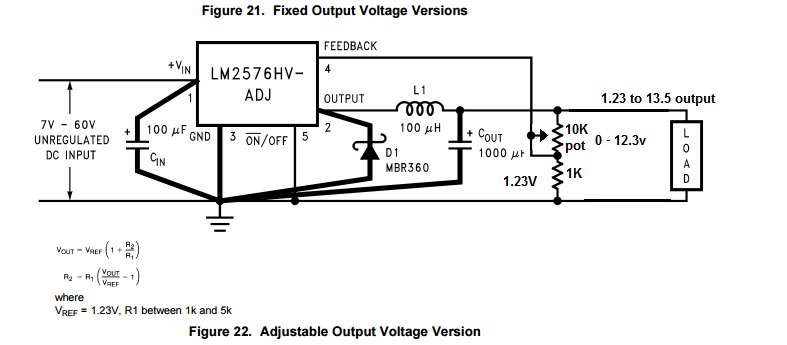

That will help. Do you suggest any diagram with few components to get it done that way. There are so many schemes on the Net but need a simple one.
https://www.ti.com/lit/ds/symlink/lm2576.pdf
Using the output of your 20v transformer into a full wave bridge and some large capacitors, you will have an efficient power supply with only a few parts. With LM2576 mounted to a modest heat sink, you will have a 1.23 to 13.5 v powersupply good for 3 amps. When outputting 10 v and 3 amps, you 20v transformer will be outputting about 1.5 amps.
I have a power supply that uses this and I'm very happy with it.
Thanks for the link. What I actually need is an adjustable voltage supply with current limiting ability.
The datasheet you link to has fixed current output. Could you suggest any alteration to the scheme to get current limit.
not fixed, Maximum
One definition of current is voltage applied divided by the load. Generally speaking, you have either voltage control and current is determined by the load with max current being set by the power supply, or current limiting and voltage is controlled by the load with max voltage being set by the power supply.
Because this circuit is a SMPS, the current in is much less than current out, and max current is limited by the LM2576. However, the attached drawing shows how the LM2576 can be used as a constant current device.
