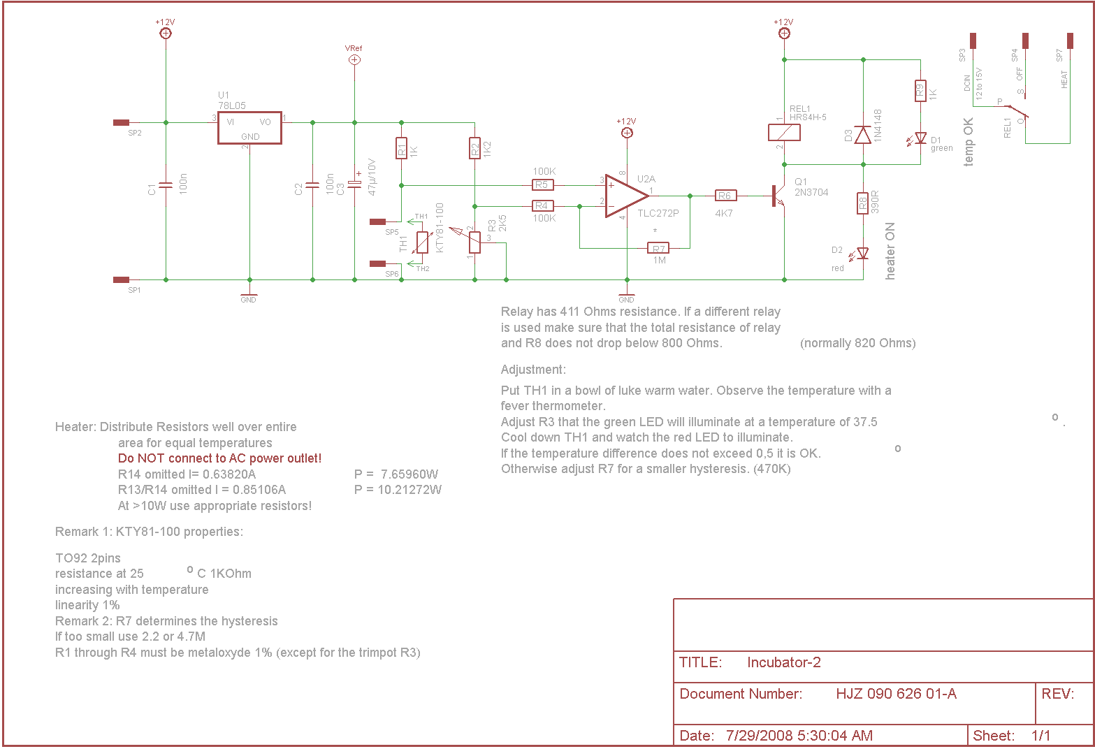

Hi cyrie,

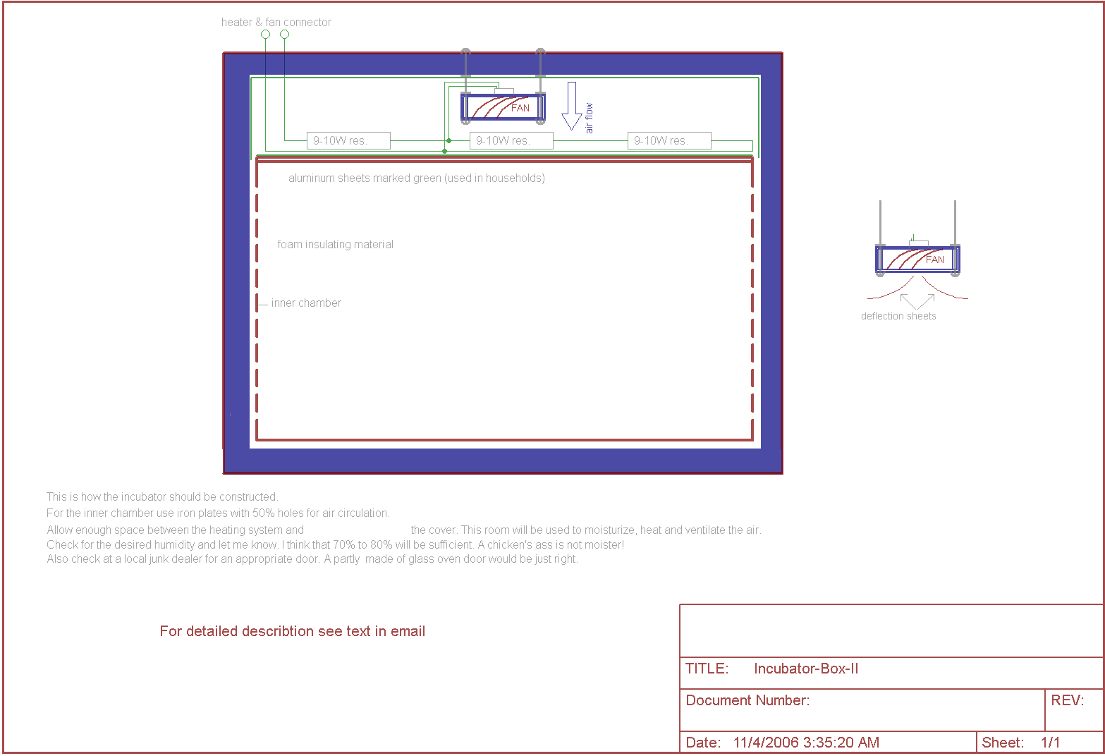

here are complete schematic diagram and a single layer PCB layout for the incubator. The zipped file also contains a suggestion for an incubator box.
Adapt the number of heating resistors to the size and ambient air temperature of the incubator box.
Schematic and PCB layout made with Eagle version 3.55. Can be used with version 4.16; for version 5.0 it must pass through 4.16 first. (and be saved using that version)
Having problems PM me.
Note: The circuit does not contain a humidifier.

The file format boncuk used is Eagle software. I tried to convert the files to an image format for you. Let's see if this works.
Actually Boncuk deserves the gratitude as he provided the circuit, I just converted the file format for you. But thanks. I had to look up senpai, :)
