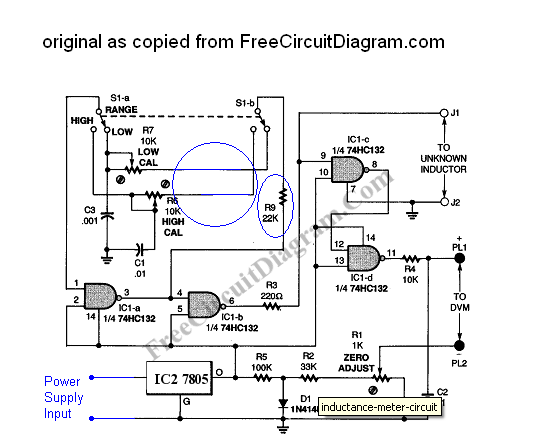

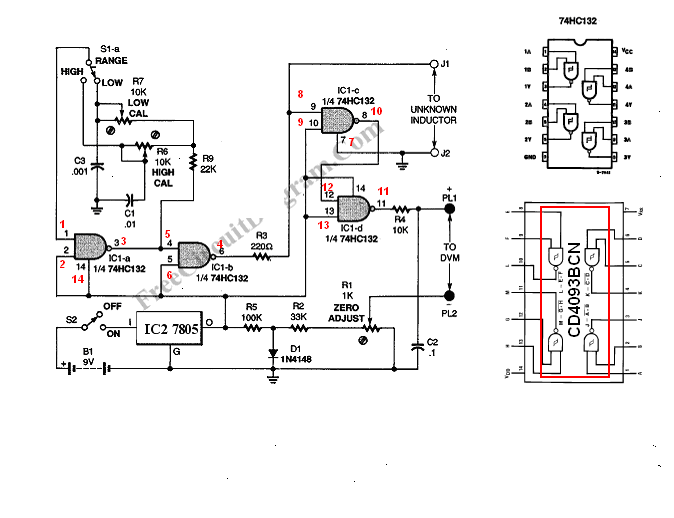

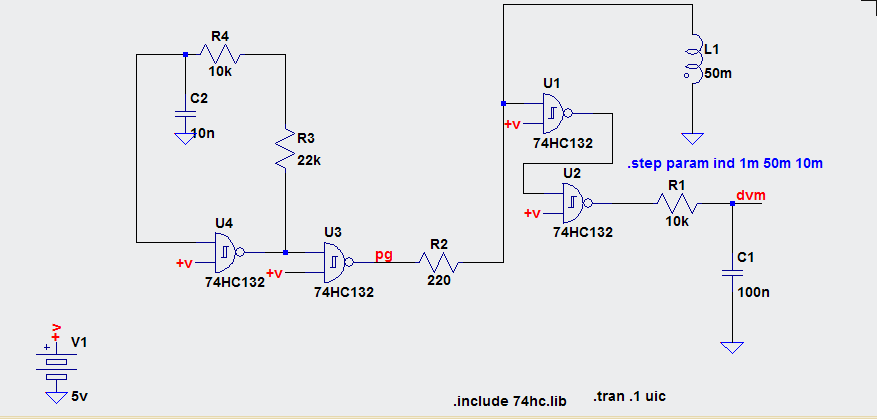

Has anyone built on of these? I tried building a Simulation and it didn't work. It calls for a 74HC132, I plan to use a CD4093BCN which has a different pin configuration because I have it. Does any one have an understanding of how it works?

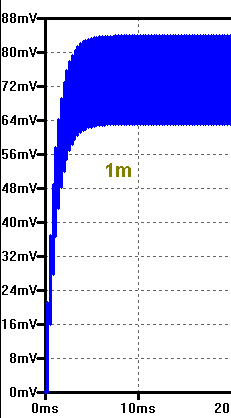

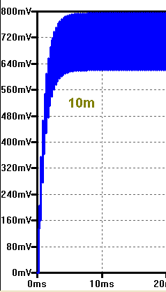

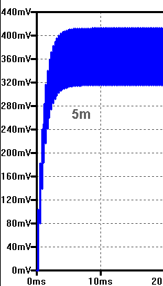

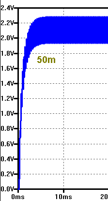

It works ok in LTspice.

Thank you Eric, could you please attach your .asc file for me to analyze, I basically copied yours, but I don't get your results, I too, use LTSpice . I guess I'll go ahead and build it and see if it works for real.

This is the part of the circuit that does the work.
All it is a square wave pulse generator driving into an inductor.

INDUCTANCE METER ADAPTER FOR DVM.doc said:
Op-Amp is 74HC132
Hmm, that's the first time I've seen anyone refer to a quad nand gate as an Op-Amp.
Thanks,
Kinarfi
Where I got the design, Inductance Meter Circuit | Circuit Diagram

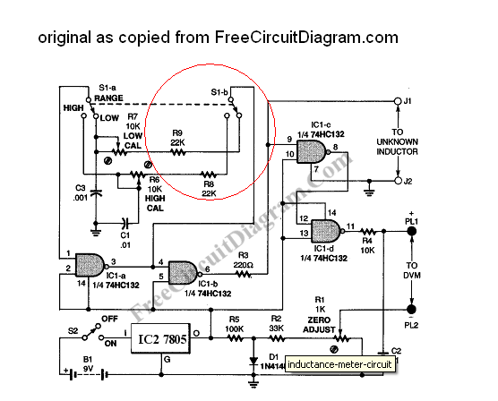

Attached is the original design with a red circle around the area I modified and made an OOPs, Since both scales have a 22k in them I figured I could just use one, and a single pole, trouble is, I didn't isolate the unused part of the scale, and got "back feed".
I can still get by with one 22k, but I still needed the 2pdt switch, attached is my current build, which does not seem to work.
