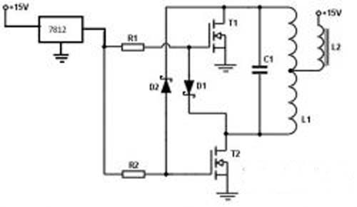

I think if you dig down in the datasheet they publish esr and maximum current at 100Khz. I think I would model your circuit and see the measurements and go from there. Have you picked a circuit yet?
Here is an idea of what I want to try. A self oscillating circuit. I am certain open to other ideas and thoughts here. Just trying to keep it reasonably simple. I was going to push to 30-50V until I can find a power level I am happy with. My lab supply will only get me so far being able to do 30V and 10A. I am not sure if you can series those to make 60V of 5A. That might be interesting to test.
Anyway, was going to play with the C1 and L2 values and test heat pieces to get an idea which works best.
Probably my biggest concern (SMPS still largely confuse me) is the power supply. I want to use this as an excuse to make a power supply. It really does not need perfect voltage regulation for the coil and all other voltages that will need good regulation, I can just use linear regs.
