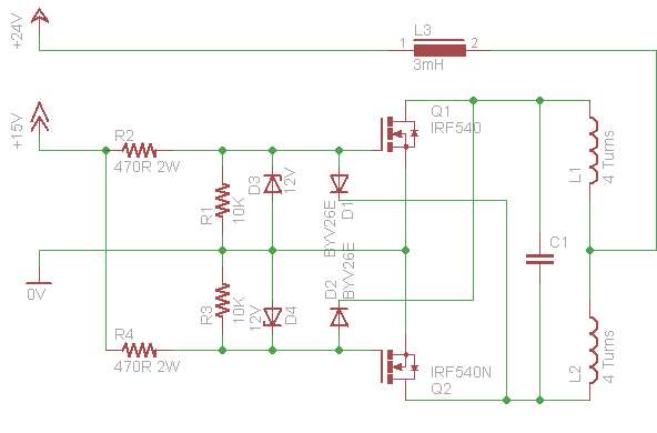

I've wanting to build a induction heater, but not winning much with it.
The problem is as soon as I power it up, it either blows the fuse (10 Amp) or pops the Mosfets.
I have attached the schem of the circuit used.
I have tried various mosfets (IRF540, IRFZ44N, IRFP460) all the same.

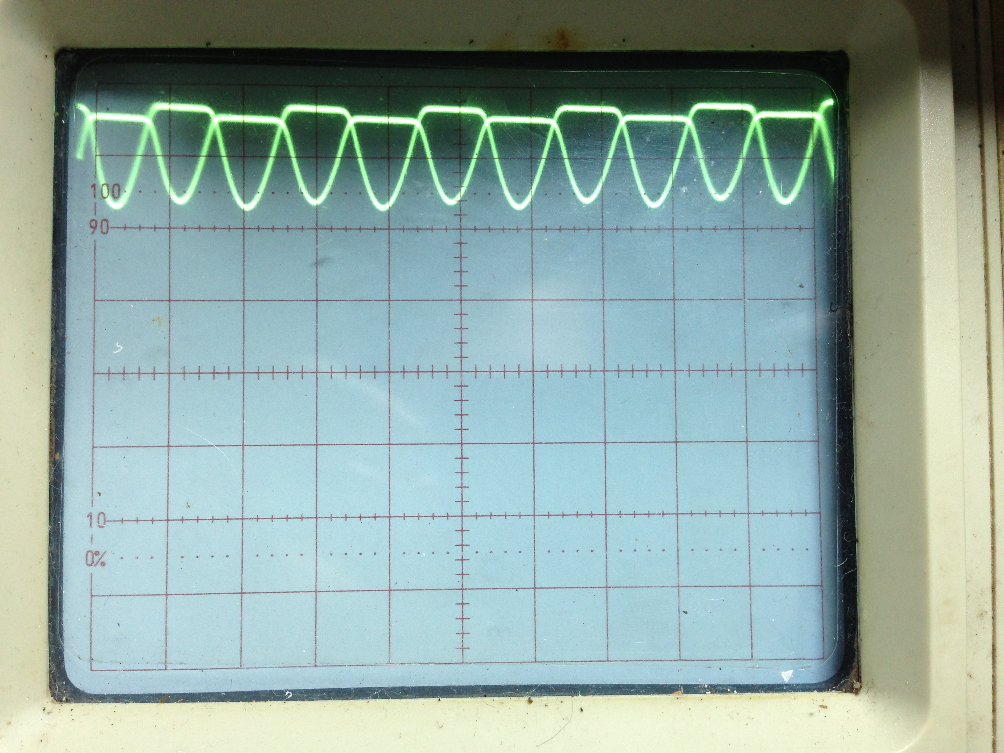

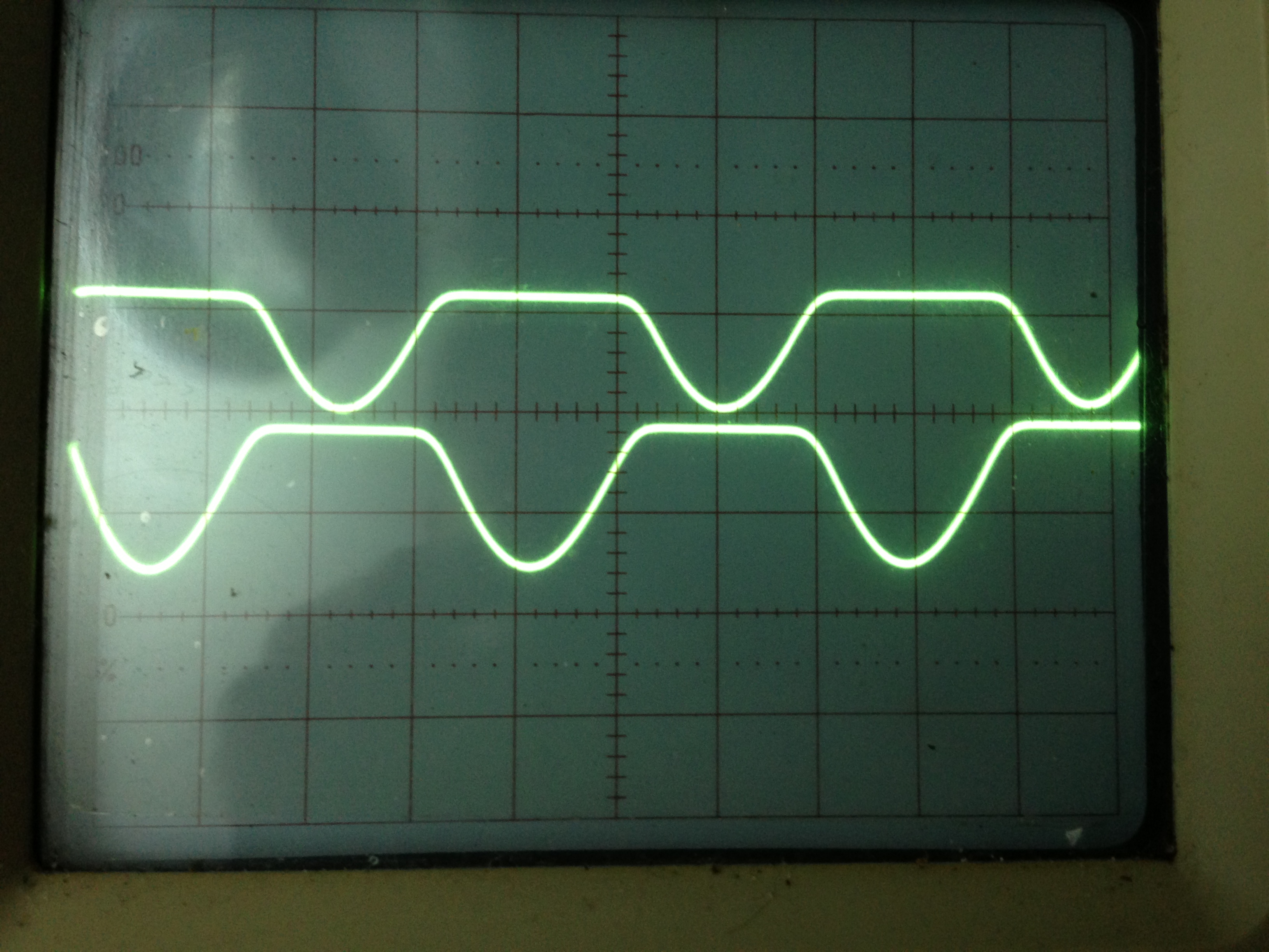

However if I only power up the +15V (LM7815) side and place my scopes probes onto the gates, I can see its oscillating, at roughly 120khz if I recall correctly, however the waveform doesn't appear to be correct, and it would appear that the gates are both high for a fraction of a second, and the voltage levels seem to be funny, with low only going down to 2.2V and high only going to 3.8V.
+24V is from a rectified Toroidal transformer with a 15000uF cap. rated for 10amp.
The work coil is 8 turns of 4mm copper tubing, the coil is 60mm diameter and 55mm long. It is centre tapped to form 4+4 turns.
I've tried various arrays of capacitors for C1 (22nF to 4uF), but it still won't start up and keeps popping fuses etc.
Any assistance would be greatly appreciate!
Thanks in advance
Justin

The other option would be to use the feedback coil to drive a pair of op amp comparators that in turn drive the IR2113 gate driver IC's inputs 180 degrees out of phase plus with that you could have an adjustable zero crossing dead band that can be used to set the duty cycle.
I think u need a bit of a deadband in your pulses as the capacitance of the FETs induce a delay in switching which could cause them to create a type of shoot thru in your circuit.
You should be able to simulate a deadband by placing a 12V zener in series rev biased config in front of the fet gates. That way only the full 12V should hit the gates and the rise/fall times are cut off and don't overlap.
Your circuit looks like the Mazzilla driver circuit. Ideally you should use mosfets of at least 3 to 4 times the supply voltage rating to allow for a safety margin.
In your case I would suggest IRFP250 or IRFP260 mosfets which are rated for 200 Volts and 30 or 46 Amps respectively.

Edit: I've just run an un-tweaked LTSpice simulation with no problem. C1 was set at 100nF and each L was set at 10uH. BTW, did you include a K directive to couple L1 and L2?
Lighty, A Royer Oscillator usually has a feedback winding as well. and the working coil has one winding instead of a centre tapped winding.

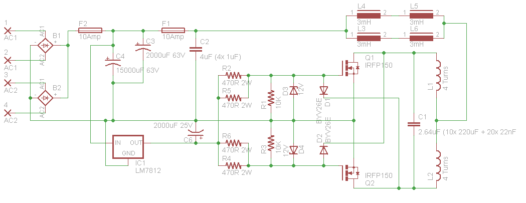

Going by your rough specs you are using a DC power source with roughly a 34 VDC open circuit voltage smoothed out by a 15,000 uF capacitor as a power source for a HF push pull type induction heater circuit correct?
Correct
First thing I question is the ESR of the 15,000 uf capacitor. Do you have any other smaller low ESR capacitors in parallel with it being you are tying to pull up to a 120 Khz pulse train off of it at peak currents of 10 amps or more?
I have a 15,000uF + a 2000uF in parallel, both 63V, but not sure on their ESR.
Second given a push pull circuit design your theoretical peak voltages each switching device may have to deal with would be 68 volts add in any inductance spikes and limited clamping and they could be seeing 10X that!
This I why I tried the IRFP460 rated at 500V, not sure if it was correct thing to do though?
Third if you are seeing a 10 amp average current drain the switching devices themselves may be seeing 3 - 5 times that peak currents as well.
If it was me I would be tempted to try and redesign the circuit initially into a H bridge with low ESR capacitors making up one half of it and your switching devices making the other.
Once you have the bugs out of that then I would change the capacitor side of the H bridge over to switching devices and run the induction coil in series with the two capacitors paralleled with each other that made up the second side of the H bridge.
That's basically how most of the large induction heater units are configured.
That's my thoughts anyway.:D
(But I did just roll out of bed too. :eek::p)
Will look at other design, but would like to get this up and running 100%, even though it may not be the best, reallity is that battling sometimes forces you to learn something new, and I got plenty to learn.:eek:
