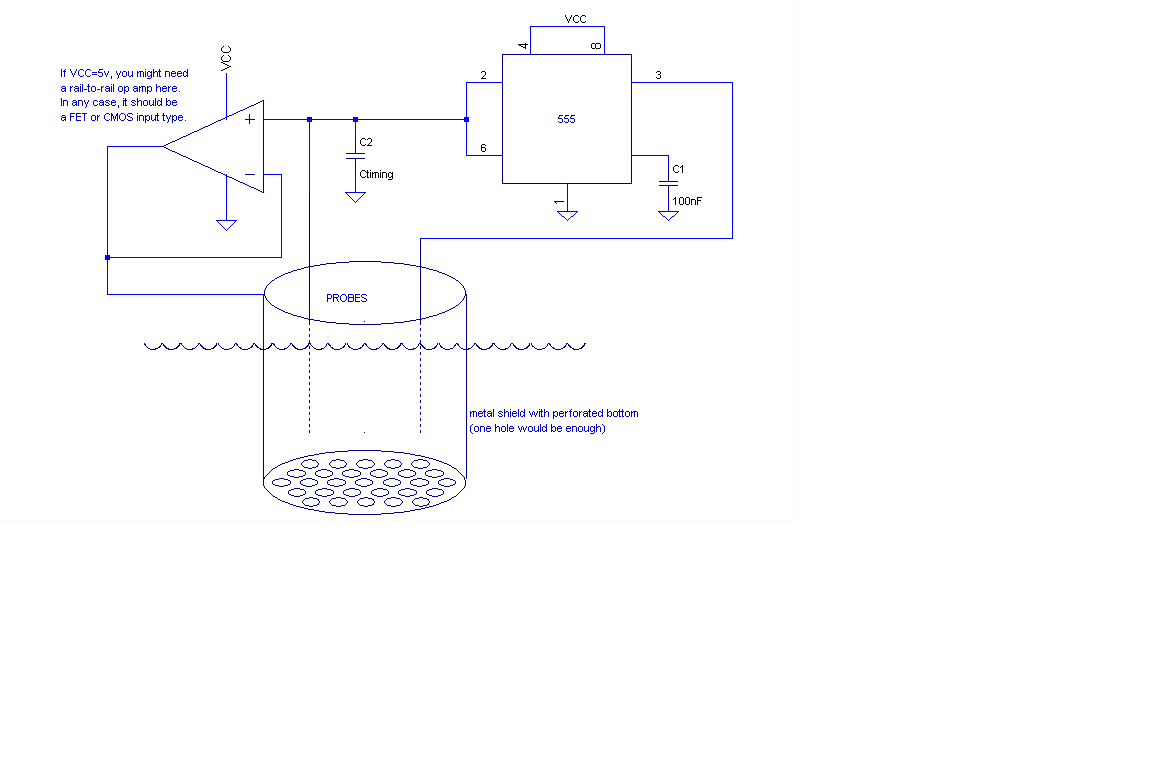

The diagram below is an idea which might solve your problem. It might still have problems - depends on how the ground shield is interacting with your circuit.
The idea is to prevent current flow between ground and the timing capacitor. The shield is kept at the same voltage as the cap. Current will still flow between the shield and pin 3 of the 555, and possibly from the shield to tank GND, but this should not cause a problem if your lowest resistance is indeed 10k, or possibly as low as 2k.
Edit:
It dawned on me after I posted this that you might get away with just having one probe down the center, from the capacitor, and driving the shield with pin 3.
Of course, you might not be able to put any sort of shield in your fish tank. Maybe it could be made of stainless steel fine mesh screen?

That sound like it will work.

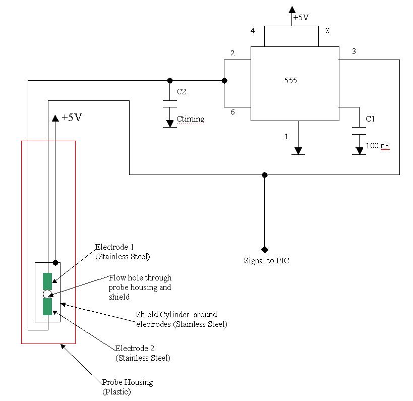

I can make a shield out of stainless steel and slide it between my probe housing and the electrodes. Here's what I can do to my existing probe prototype, do you think this will work correctly....

I described two ways of shielding the probe(s). Your drawing implements neither of them. I don't think it will work to tie the shield to +5V. Current will flow from +5v, through the liquid, and to the capacitor, screwing up the bias.
I see now. I forgot all about the second option of using the capacitor line as a probe and pin 3 to the shield. I'll give bot of your suggestions a try.
I tried the shielding ideas, I still get different readings with the probe in the tank versus the probe outside the tank in a sample of the tank water.
I made two shields, one was a thin sheet of stainless steel with a stainless steel mesh soldered to one end. The other was just a a cylinder of the mesh. Both were connected to pin 3 of the 555.

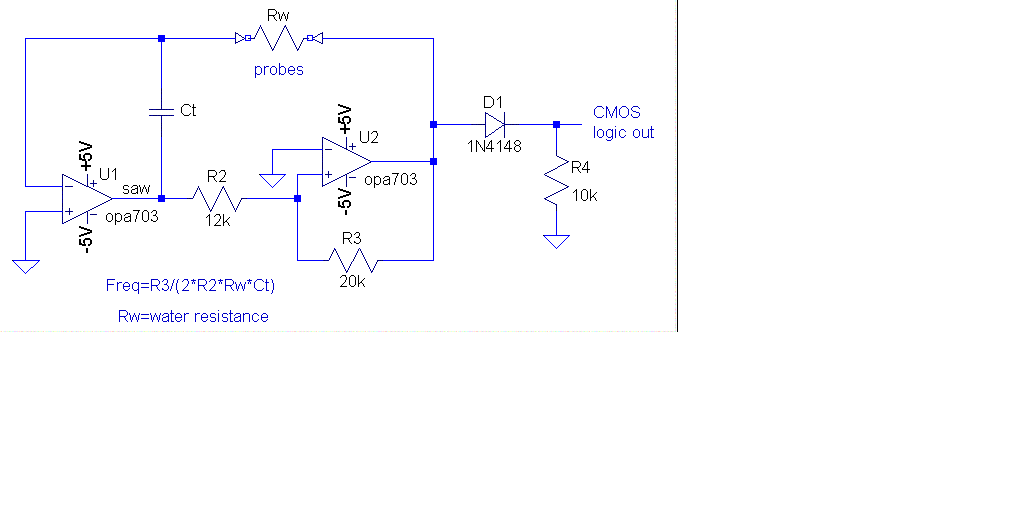

Did you actually try the version with the op amp? It was the one I had the most hope for.
I have one last gasp - see below. This doesn't require a shield. It relies on the fact that one probe is at virtual ground, so no current should flow to the tank ground. If your resistance from either probe to tank gnd is less than about 10k, this probably won't work - nor will the other two.
It is very important that circuit GND and tank GND be at exactly the same potential - two "grounds" are not acceptable.
