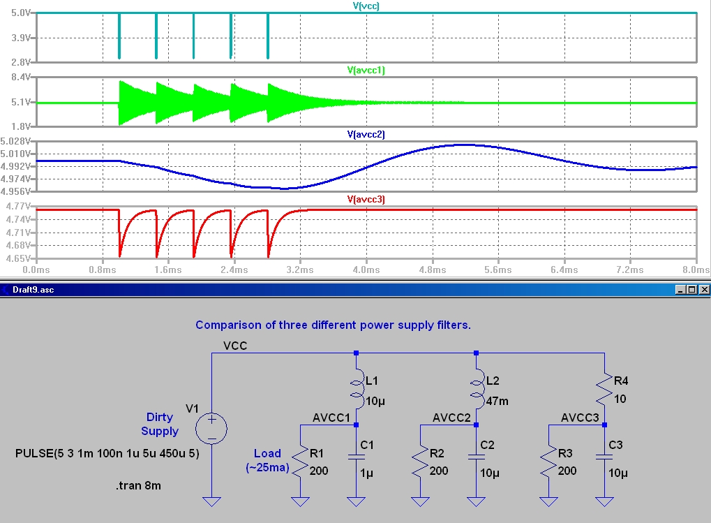

What does the following circuit produce at AVCC? I know absolutely nothing about inductors at the moment, so i have no idea
AVCC is connected to AVCC pin on an Atmega16.
