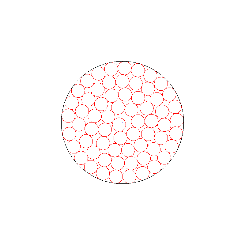

There are a few other problems that come up too such as do all the turns fit inside the toroid window, and surface area vs heating. Here's a drawing of a toroid core center window that is entirely filled up with wire. If we needed more turns, we'd have to go to a larger core.

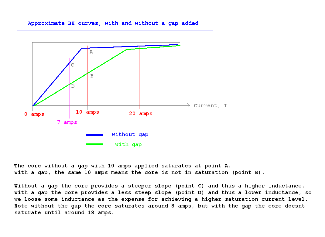

As RC points out, the gap reduces the inductance and it also stretches out the BH curve horizontally. What this means is that it takes more current through the winding to reach the flat portion of the BH curve and therefore loose inductance. This is especially useful in DC power supplies.
The gap is not entirely unique for achieving this goal however, as a lower permeability core also allows more DC current through the winding before saturation.
As the attachment shows, adding a gap has benefits and drawbacks so a gap is only used when necessary.
