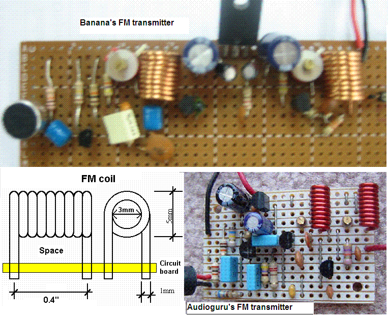

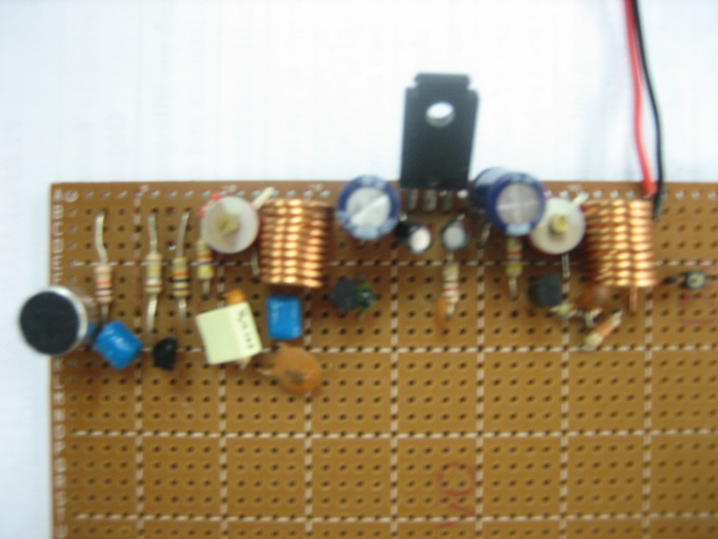

I bought the trimmer cap from an electronics shop. The Fm transmitter is mod4 by audioguru and the photo of it.

Thanks for posting the picture and the other info. I think the trimmer is probably OK.
It is still difficult to see if there are hookup problems so a picture of the bottom side would be useful too. However, one thing I am wondering about first is whether the turns on your inductor might be touching each other. It is critical that each turn of the coil not touch either of the turns before or after it. This can happen if you use bare copper wire. Notice that Audioguru's example in his photo uses coated wire (that's why the wire is red) which insulates one turn from another. Take something thin and push it between each turn. This would put a small air gap between each turn. See if that is the problem.
I notice that your coils are indeed larger than Audioguru's example. His appear to be 0.4inches long, 9 turns and 0.2 inches outside diameter. His layout is also much easier to follow against the schematic. Why did you not follow his component placement and wiring example? At these high frequencies, component placement and wiring is as important to the performance as are the component values.
Yes, I'm using enamel coated wire, pretty sure. Are you sure the diameter of his coil is only 0.2 inches? Then mine is almost twice of 0.2 inches, the rest of the measurements are almost the same.
For his layout design, if I've not mistaken, one or two components are placed at the bottom of the veroboard. My placing of my layout is almost the same as the schematic.
It is easy to see in his photo what the sizes are because the holes in the pcb are spaced by 0.1 inches
I am puzzled by those parts near the collector of Q3 on your board. Looks like two resistors and a small capacitor. What are those parts?
I don't know what else to suggest at this point. One other minor issue is that the components close to the coil can alter the inductance but usually the alteration is small. You have components right up against the coil, but I don't think this would vary the inductance enough to explain the problem. Can you take a picture of the other side of your board?
If I had this board in front of me, I would first inspect it very carefully especially around the tank circuit of Q2, which determines the frequency. I would make sure that the connections are exactly as shown in the schematic, and that the capacitance and inductance connected to Q2's collector is as they should be. I think I would also disconnect C12 to simplify the circuit temporarily and see if this changes anything. I might also temporarily disconnect R2 as well to shut off Q1 to help simplify and isolate the oscillator, Q2.
Ha.. The capacitor and the resistor in horizontal are not shown in mod4, I added them at the emitter of Q3 to reduce the power dissipation of the transistor as I felt it is getting a little warm when it is turned on. While the 45 degree 33 k:eek:hm: resistor is the R3 for Q1. I used 180 k:eek:hm: and 33 k:eek:hm: which are available for me to form the voltage devider.
Banana,
Your coils are much bigger than mine.
You have the RF amplifier spaced very far away from the RF oscillator so the stray capacitance and stray inductance is increased a lot.
Now only I realize that my coils are bigger. But in logically thinking, my coil has higher inductance than it is supposed to be, plus the stray capacitance and inductance, the frequency should be much lower than expected right?
