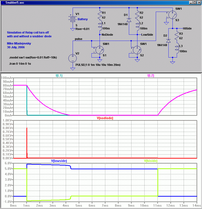

Maybe this will help.

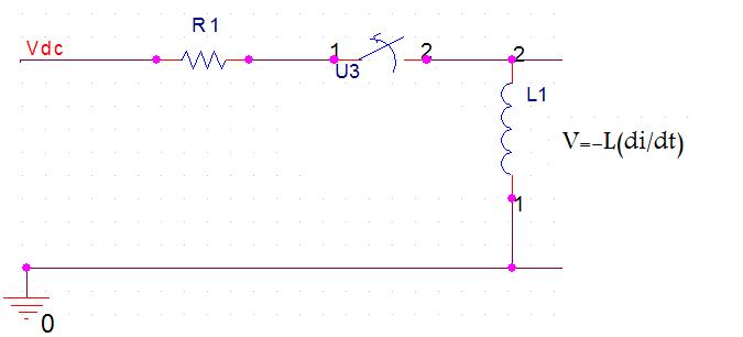

Can you show it with a schematic? Yet I am not able to see why the current following at the same direction to the source will causes the polarity of the voltage to be reversed?!!
Refer to the attached schematic, the moment the switch is opened, V1[L1] will have higher potential than V2[L1]. The current will still be flowing from 2 to 1.

It's more accurate to call it a current source, with the voltage equal to the current multiplied by the impedance of any attached circuitry including the parasitics.
An ideal current source generates a current independent of the impedance it is driving.
A real current source, of course, has practical limits as to the maximum voltage it can provide when generating this current. An example of a such a current source is a power supply operating in the current limit mode. It will provide the set limit current up to the maximum output voltage of the power supply.
