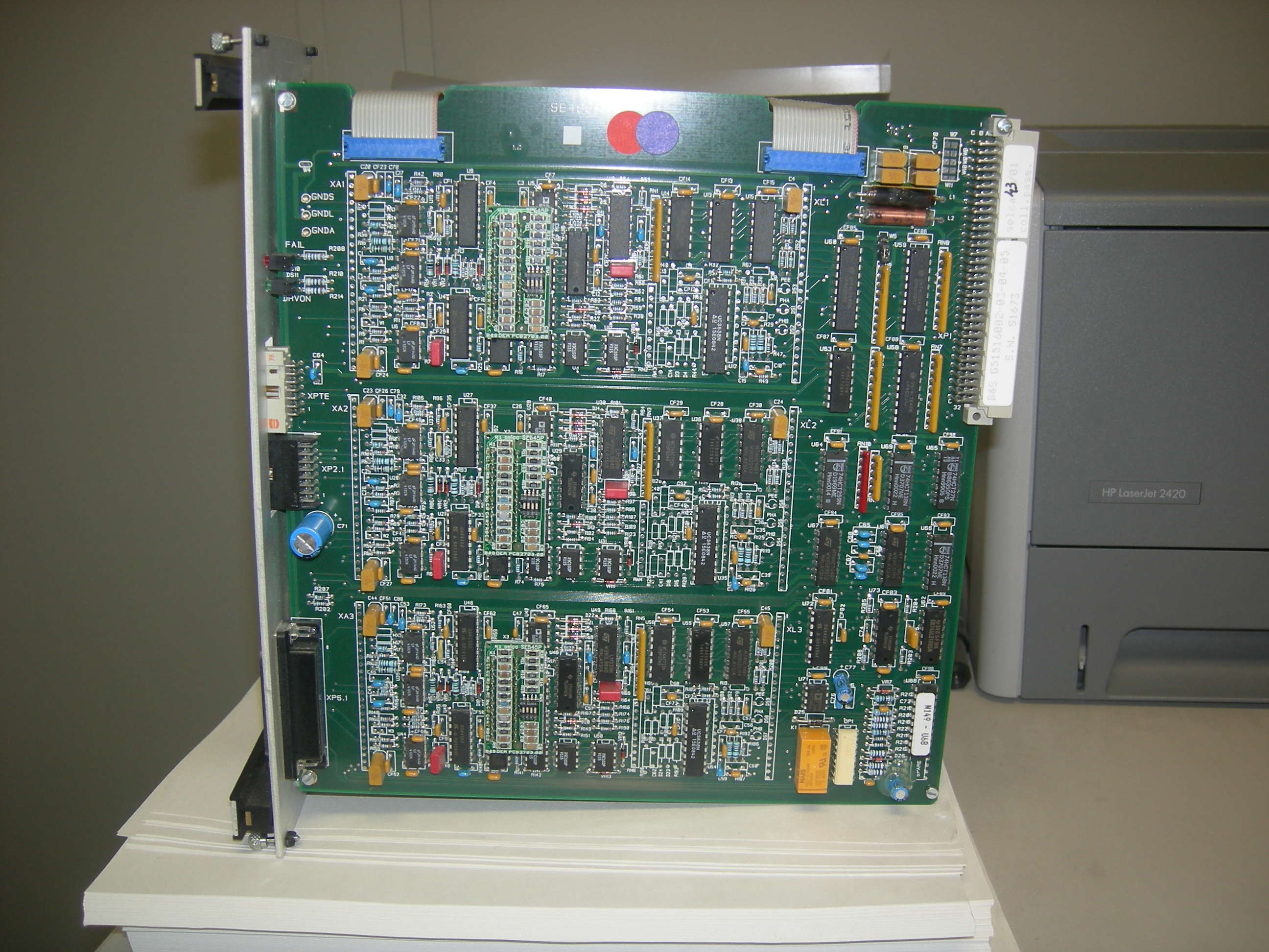

Hello,
I am looking for what I think is an Inductor, It goes on a circuit board for a CMM machine. It has a number of 565-2 on it and seems to be made by a company that starts with a F. It looks similair to a resistor but has small copper windings on it. It is rated at 100 micro henry's and 1 A. Can anyone help identifying? You can see the burnt one in the upper right hand corner of the picture. If a closer picture is needed, I will try.
Hi Tjones,
Inductors don't fry that way without a reason, it's only a length
of wire wound on a former or a core. By the look of it I can see
that it is well done, so it has passed a considerable amount of
current. There will probably be a dead short on that power supply
line. Replacing that inductor won't do the trick, you gonna have
to dig deeper to find out what caused the excessive current that
fried your inductor.

Tjones said:
Hello,
It looks identical to the inductor next to it, they appear to be connected to the pcb connector on the right handside.
Its looks like a supply line filter, that value of 100uH and 1A rating would be easy to source.
My concern is that the actual problem is the main board itself and the choke/inductor has burnt out due to over current.
If you replace it without finding the problem, most likely a short, the replacement will also fail.
