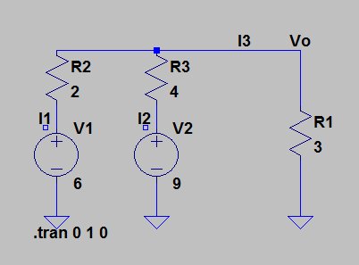

Now to your work. Your equations for I1 and I2 would only be true if the voltage at the common node is zero, which it is not!
You must solve for the voltage at the common node.
If you call the voltage at the common node (the one that you apply Kirchoff to) Va, then the current through the 2Ω branch is I1 = E/R = (6-Va)/2...
I'll let you write the other two current equations...
btw: is the neg end of the 9V battery supposed to be floating?

Regarding Q1 as I will come back to Q2 when I have time....
See attached for naming convention. Using nothing more than Ohm's law.
Vo=I3 x RL
I2=(V2-Vo)/R3 = (9-Vo)/4 = 9/4 - Vo/4
I1=(V1-Vo)/R2 = (6-Vo)/2 = 3 - Vo/2
I3=I1+I2...splitting the bottom of the fractions gives..
I3=9/4 - Vo/4 + 3 -Vo/2
replacing Vo with I3 x Rl
I3=9/4 - (I3 x Rl)/4 + 3 - (I3 x Rl)/2
Rl=3
So I3=9/4 - (3 x I3)/4 + 3 - (I3 x 3)/2

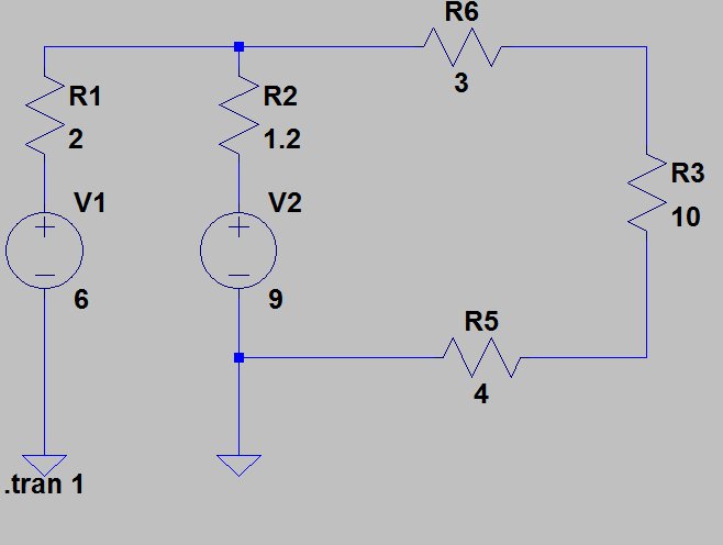

I think this is how it is done. Forget R3 R5 R6.
Short V2 and using thev you get 2.25V with 0.75 ohm
Short V1 and as above you get 5.625V with 0.75 ohm
Add the voltages and parallel the resistors and you get 7.785V with 0.375ohm
Total current through the loop is 7.785/(0.375 + 3 +4 +10) = 0.4532A
Across the 10ohm using V=IR gives 4.532V
Not sure if method is correct as there is 30 years between learning and doing this, but LT Spice comes pretty close. I would be interested in an alternate method.
Q4. 0.41A. Sorry no clues yet.
