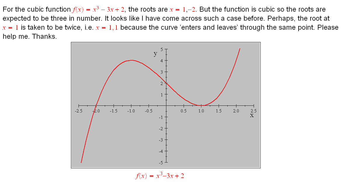

Not sure what your question is for the inequalities this time.
Real quick:
The solution to the cubic has a repeated root at x=1. To prove this, you should be able to multiply all the x minus each root and get the same equation as such:
(x-r1)*(x-r2)*(x-r3)*...*(x-rN)=same equation
So for this example we have:
(x-1)*(x-1)*(x+2)=x^3-3*x+2
because we had a repeated root of +1 and a single root of -2.
Note this works because if the original equation was equal to zero:
x^3-3*x+2=0
then the 'new' equation knowing the negated roots must be equal to zero:
(x-1)*(x-1)*(x+2)=0
and that means that each product must be equal to zero:
(x-1)=0
(x-1)=0
(x+2)=0
Or you could look at the other way around: because each product is zero the new equation is zero and so the expanded version must be the same as the original.
