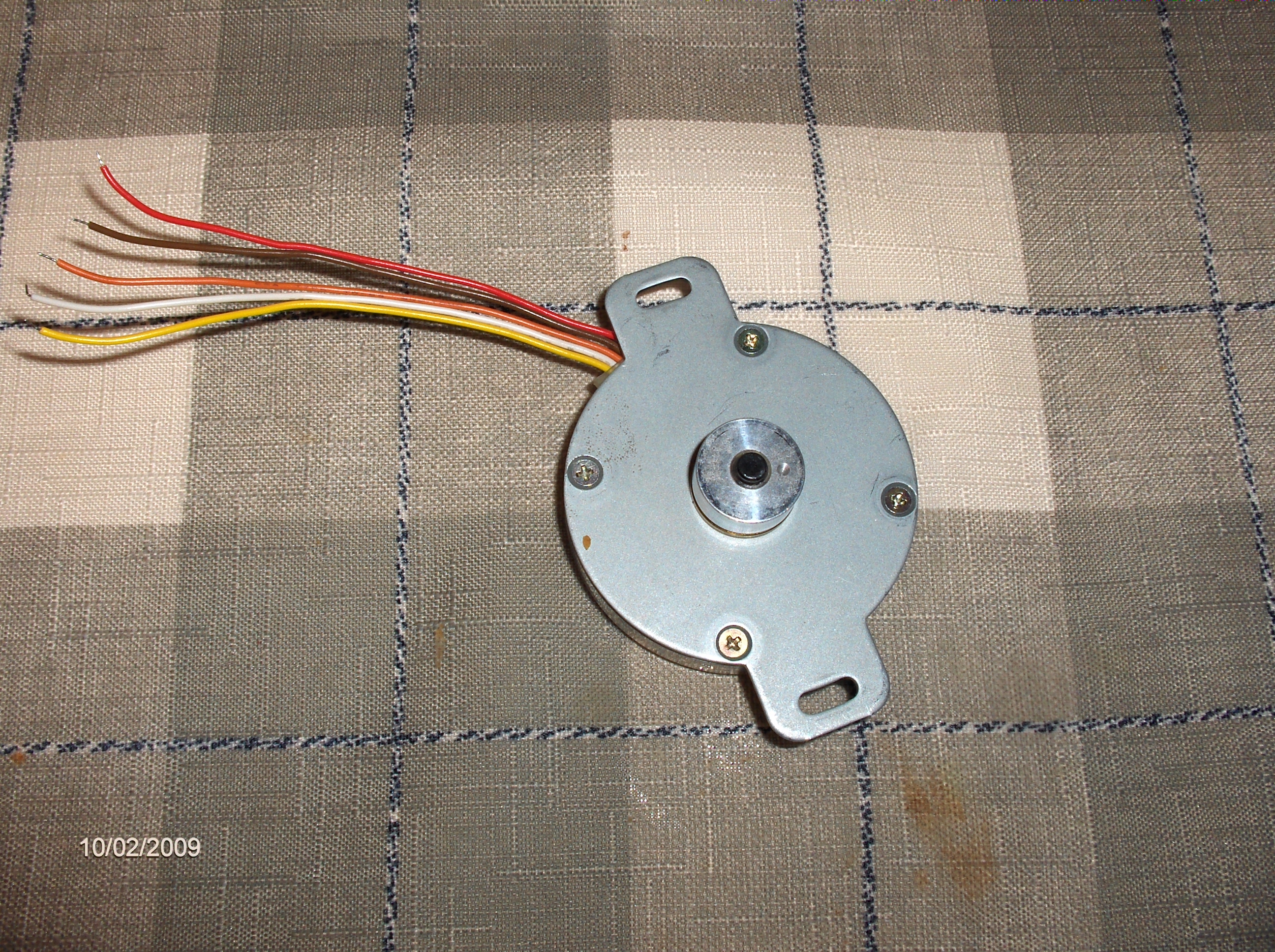

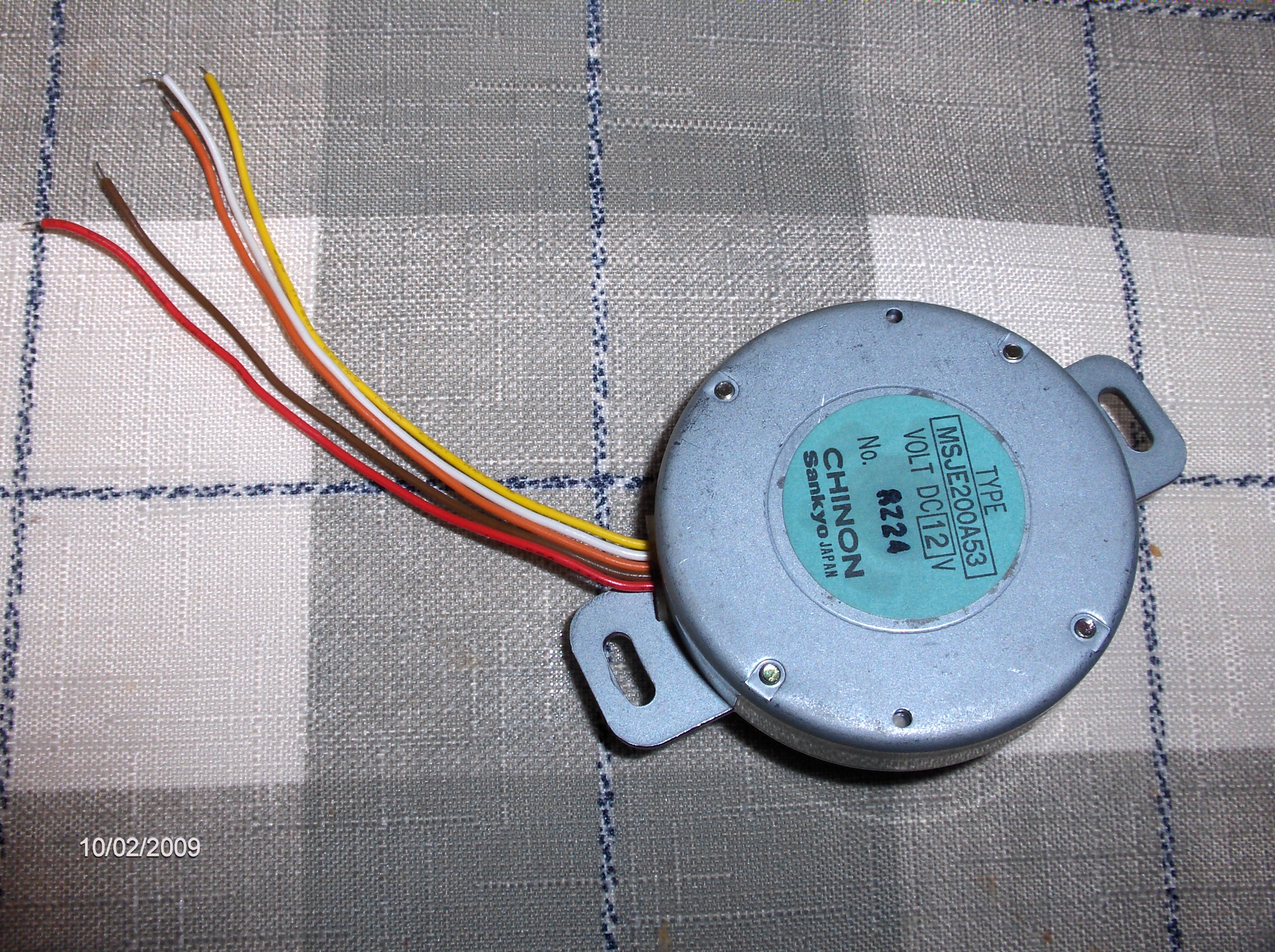

doesn't seem like anybody sells micro wind turbine <10w. You may have to make one yourself. For ideas see Wind Generator from old scanner [updated]
Instead of stepper motor which will probably give you 5v, you can try a 12vdc (ac/dc) portable fan such as 12" fan from walmart for $10. Search around any permanent magnet motor or toy motor can be used or maybe some other member has an idea, may have to use two of those to get 24v. I have one such fan and may do that myself, just will have to change the blade to a 2 or 3 blade instead of what comes with it.
That only produced a few volts at 300rpm. I tried a scanner, printer head and paper stepper motors with similar results.
Then I got an old 5 1/4" floppy drive stepper motor for head movement, it is a 12vdc, see pics. This one produced 7v, 11v, 11v and 14VDC (red and white wires on outside) at 300 rpm! That's promising. It's about 2.25" round and about 1/2" thick.
