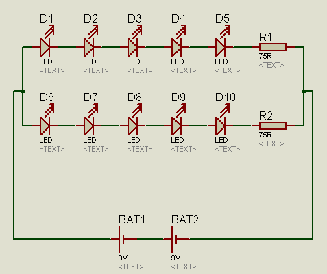

Hi, i'm having a little prob with making a homemade infrared camera. It really seemed much easier the way they shown it on youtube. 1.) I'd like the "IDIOTS GUIDE TO CHOOSING A CAPACITOR":D 2.) I'd like help with my specific application. I've chosen 10 high-output infrared leds from radioshack, ( output = 16mw min , forward volt.=1.2v , forward curr.=100ma , wavelength= 940nm) 2 10ohm resistors & 2 9v batteries. I've arranged the leds in sequence, in 2 rows of 5 LEDs, with 1 10ohm resistor per row. I'm obliously doing something VERY wrong here because i can't get a flicker outta these things. I wan't at least get 30min of full intensity out of these things ( i'm sure this may be impossible but, PLEASE humor me).

so you made a block of 5 leds + resistor in series and connected that block to 9V battery.
Vf = 1.2V
If = 100mA
5*1.2 = 11V so 5LED's need more V to operate with full intensity.
You can connect your 2 batteries in serial to get 18V. Use the 2 block in parallel (as in series you will need 22V meaning - more then you have).
I trough every block is (V-Vf)/R = 18-11/10 = 7/10 = 0.7A .. this is 7x more then those LED's are rated for. As If is rated 100mA (0.1A)
0.1A = 7/R -> R = 7/0.1 = 70Ω
so, connect the leds like in attached pic
hope this helps

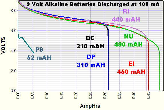

Note that this will take some 200mA from your batteries. If we assume you are using some good duracell 9V batteries (Ah at 0.100A is ~0.3) we can calculate that you can theoretically get 1.5 hours of light. The theory and practice does not always agree as 9V batteries will drop below 9V much sooner so LED will be lit much longer but will start to loose brightness much sooner.
EDIT: source of the attachment: Discharge tests and capacity measurement of 9 volt transistor radio batteries

1.)The picture that you uploaded seems similar to what i have, is there any difference that i'm not seeing here?
2.)The battery requirements are 2 or 3 9v?
3.)The 70ohm you figured is the resistor i should go with?
4.)This diagram doesn't seem to have a capacitor, does my project need one?
As Bill told ya, re-check the 100mA forward current rating as I personally never saw the IRED that can work continuously with 100mA, only pulsed.
1. I'm not the ascii art expert so dunno .. I saw your ascii art differently then what I have drawn :( and I understood your explanation differently from what I have drawn.
2. if you connect them the way I have drawn, with 2 75R resistors, 18V (2 batteries) will do the job (will provide 100mA per chain). In order to find out how long that will last - you have to try. In order to double the time add another 2 batteries in parallel to these two, or use 2 batteries to power one chain and another 2 to power second chain.
3. 70R is the "ideal" size (you need one per chain) if you power the chain with 18V (70R does not exist iirc, you need to use "first bigger" that is 75R). And I did not "fiured" it, I just calculated it :) ... the formula is simple I = (V-Vf)/R where Vf is sum of all Vf's of the led's you have in chain.
4. no need for it, you are powering the LED's from batteries, they are "clean" power source so no need to "smooth" it :)
NOTE that if you misread the datasheet and these IRED's can only be pulsed at 100mA (and max constant current is ~30mA) they will burn out after few sec's (maybe even faster).
btw, how are you making camera with led's ?? do you just want to make IR light source so your ordinary camera can "see better" or ?
The calculation of 5*1.2V=11V is wrong. It is only 6V. Before I was wrong and said it was 5V.
With an 18V battery and a 70 ohm current-limiting resistor the current is 171mA.
