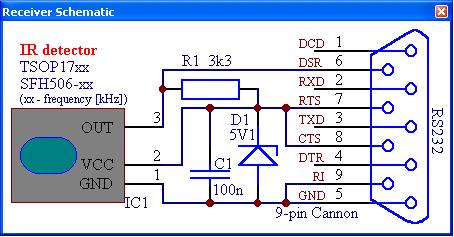

ya. .the receiver is a TSOP of 38Khz......
i am attaching the circuit of the receiver.
well the thing is girder is able receive commands form all the ir tv remotes.. i have tried all the remotes i have in my house.. all of them gave their own specific respective codes constantly. onyl my iriver clix mp3 player was an exception, but i guess they use a different frequency.
now what i want to ask is.. how should i send the codes and for now what codes should i send so that i can check wether i am getting same constant output in girder... i dont have access to an oscilloscoope..... and for now data is not important.. i just want to communicate between the transmitter and receiver and get constant codes at the receiver side..
Like I've said all along, send IR remote codes - not just random values with no type of coding - if you check the SIRC's system in my tutorials it explains how it works, and it's a VERY simple system to transmit or receive.
You are transmitting 40 KHz and the reciever is 38 KHz.
Perhaps life would be better if you used the same freq for TX and RX. The 38KHz TSOP may be reading the 40KHz but there is no down side to getting it right. It uses the same TX hardware.
Not a big deal just shorten the correct delay in the TX code. If you TX a steady 38KHz the output of the TSOP will go low. If you can not calculate the delay you find it the hard way. (Longest delay that works + Shortest delay that works)/2.
Since the GIRDER can accept commands from most any remote use the commands in Nigels Tutorial. He has done a good job of documenting them, why use anything else?
When I did this I coded in C rather then Basic or asm. You need to get the delays right to produce 38KHz (not 40), Then you need to get the on off times right. Not much to it.
