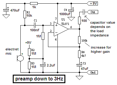

The output level of a microphone is about only 5mV. The input level requirement for a power amplifier is about 500mV. A preamp amplifies the output of the mic to about 500mV. the preamp also powers the FET transistor inside the electret mic.
Then a lowpass filter circuit can be added between the preamp and the power amp.

Velleman have hundreds of kits. If you have the K1803 preamp then it is the wrong one:
1) Its input impedance is too low becuse it is made for a low impedance dynamic mic. Your mic is a high impedance electret mic that needs a high impedance load and needs to be powered.
2) Its frequency response is 3dB down at 72Hz.
3) It uses a lousy old 741 opamp that produces lots of noise.

Those preamps don't show their schematic so we can't see if the input capacitor can have its value increased for it to work at lower frequencies.
The Velleman preamp doesn't power an electret mic and has an input impedance too low for one.
This is the preamp you need:
The TL071 single, TL072 dual and TL074 quad opamps are low noise, low distortion and wide bandwidth. They have been used in stereo equipment for years. They have FET inputs so are easy to bias. They were invented by Texas Instruments but many manufacturers make them.
Their minimum total supply voltage is 7V.
