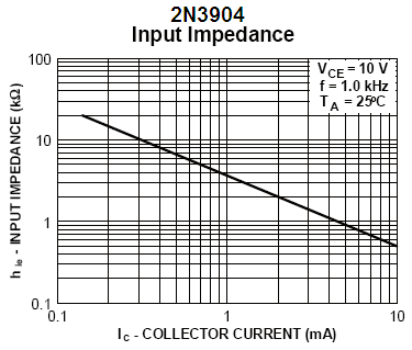

The datasheet of the 2N3904 has a graph of its input impedance at 1kHz at various currents. It is its typical hfe x its internal emitter resistance.
