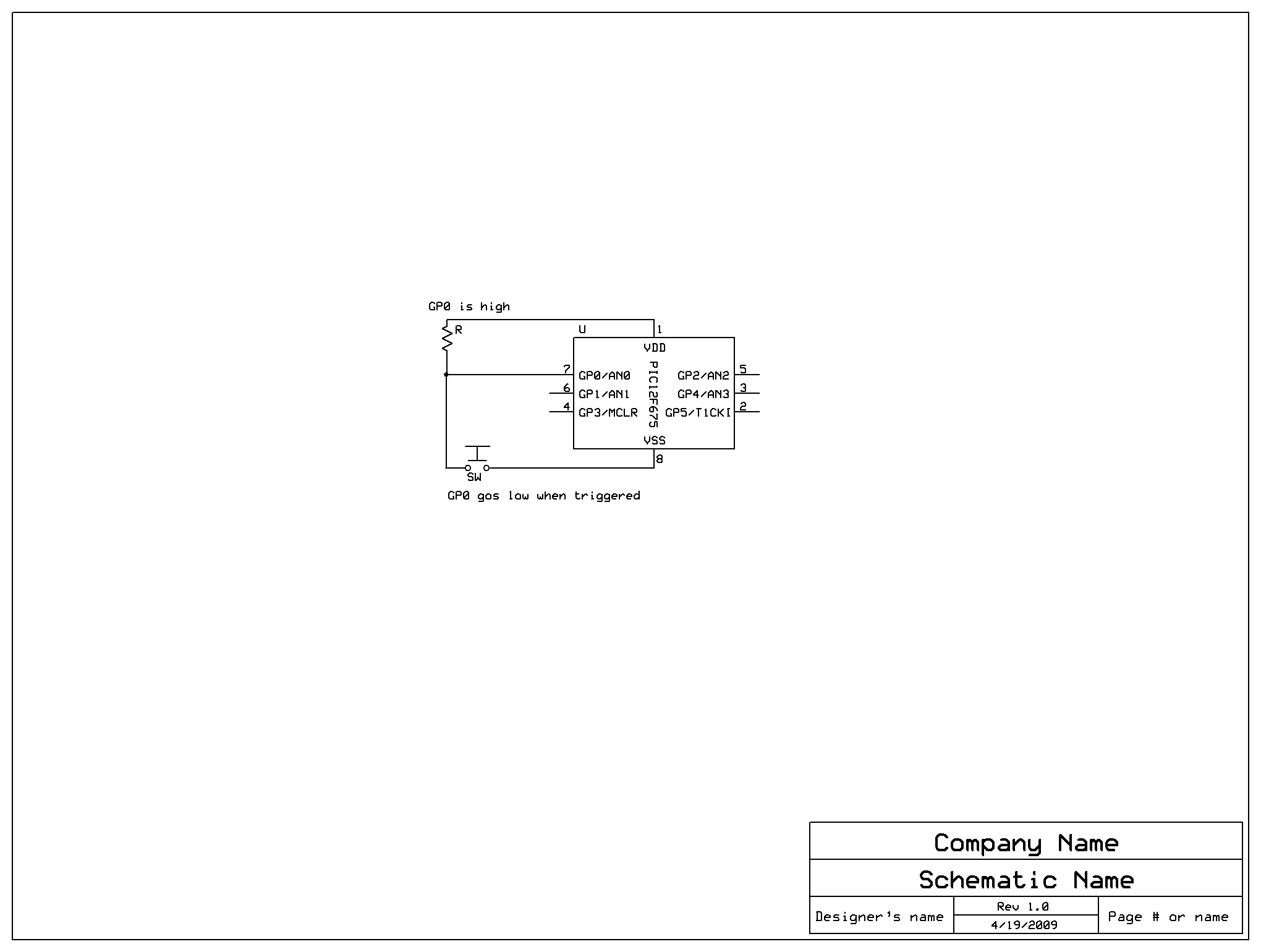

I you make say GP0 an input and use a pullup resistor to VDD the pin will read as High or 1
And would read as high till you switch it to VSS this shows maybe better
