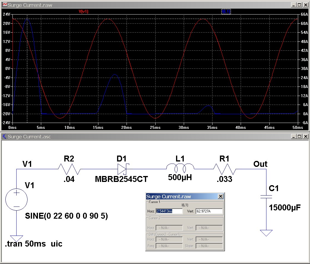

Just another question. Won't a 500uH power inductor between the bridge and the cap. block fast inrush currents & transients as well?
Fairly well. I did a SPICE simulation applying the voltage during the peak of the 16V sine-wave (which can occur with random switch closure) into 500µH in series with 15,000µF and 0.073Ω, and the current surge was about 69A. That's well within the 35A diode's surge rating.

I originally did the simulation with Electronic Workbench (Multisim) but here's the simulation with LTspice. I used a different diode so the peak current is slightly different.
View attachment Surge Current.asc

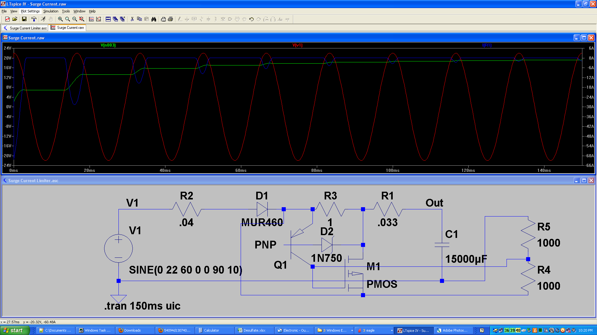

here is my 1st attempt at LTSpice!
A Pnp/PFet pair to limit the current based on a 1 ohm current sense induced drop across the PNP base & Zener.
Max inrush is now 61 amps. With less losses than an inductor system at high current. No thermistor thermal lag.
Blue= current.
Red= AC in.
Green= Capacitor voltage.
What is the purpose of the forward biased zener in the base of Q1? Zeners generate their voltage in the reverse direction.
You need a resistor in the base of Q1, otherwise high current will flow through the base emitter junction during start-up and likely blow the transistor (the blowing of components is not directly simulated in LTspice).
If you post your .asc file I'd like to simulate the circuit.
