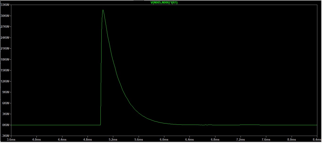

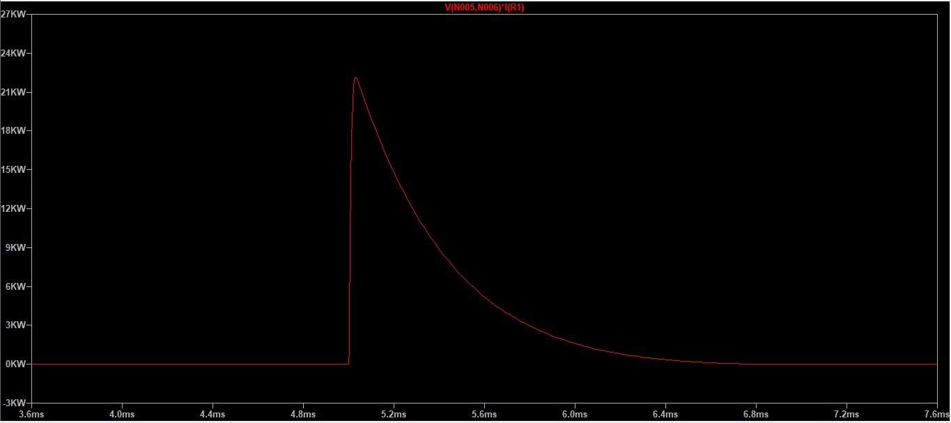

Inrush NTC must handle 32kW peak power waveform.....will it be damaged?
We are using the B57234S0509M NTC.

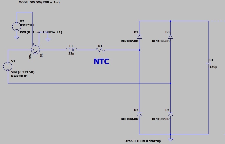

Its for inrush into a 190-265VAC offline flyback SMPS with an input electrolytic capacitor of 150uF.
The schem and inrush power waveform is as attached (this is with mains applied at mains peak and when VAC = 265VAC. (Also, LTspice schem is as attached).
Do you think this NTC can handle this ….how many times?
The datasheet gives no indication of i^2.t or allowable power vs time waveforms.
The 3R inrush NTC energy is 16Joules, and this is over 500us. Datasheet doesn't verify this.
If ambient is 40degc at the time of switch ON, then there is a 33kW peak power pulse (as shown). I strongly doubt that this little NTC can handle this without some damage?

Well, consider that the inductor and the diode will provide some "resistance" to the AC voltage in the first surge. It may work out to be close to 1 ohm for the first cycle, but that is a wild guess....

A 150 μF capacitor charged at the peak of mains voltage will contain about 10 J of energy. If it's charged from the peak mains voltage, via a resistor, the heat energy in the resistor will be about the same as the energy in the capacitor.
The NTC has a thermal capacity of 1530 mJ/K, so the 10 J of energy will raise its temperature by about 15 °C or °K, or about 28 °F. That seems fine to me.
The in the test with the 700 μF capacitor, the 1 Ohm resistor is probably there to stop the current getting excessive once the thermistor has warmed up. There is about 5 times the energy in the 700 μF than in a 150 μF, and just about all of that energy will end up in the thermistor, so I don't think you will have a problem with the 150 μF inrush.
Thanks, but do you think the thermistor can physically rise up by 15 degc in 500us?...surely it will cause a stress crack?

The whole idea of an NTC inrush limiter is to reduce the current surge when turning on near the peak of the supply. An alternative would be to turn on near zero. If that is done, there's no need to have an NTC limiter. However most power supplies don't have any active components before the rectifier and capacitor, so a circuit to wait for zero volts would be quite complicated.
If the turn-on is near the peak voltage. the 15 °C rise will be very quick. The time constant will a bit under 1 ms, so the heating of the thermistor will happen in about that time. The NTC will reduce the damage to the switch, fuse and capacitor, which is why it's fitted.
This application is using the NTC exactly as it is intended to be used, so it'll work fine.
